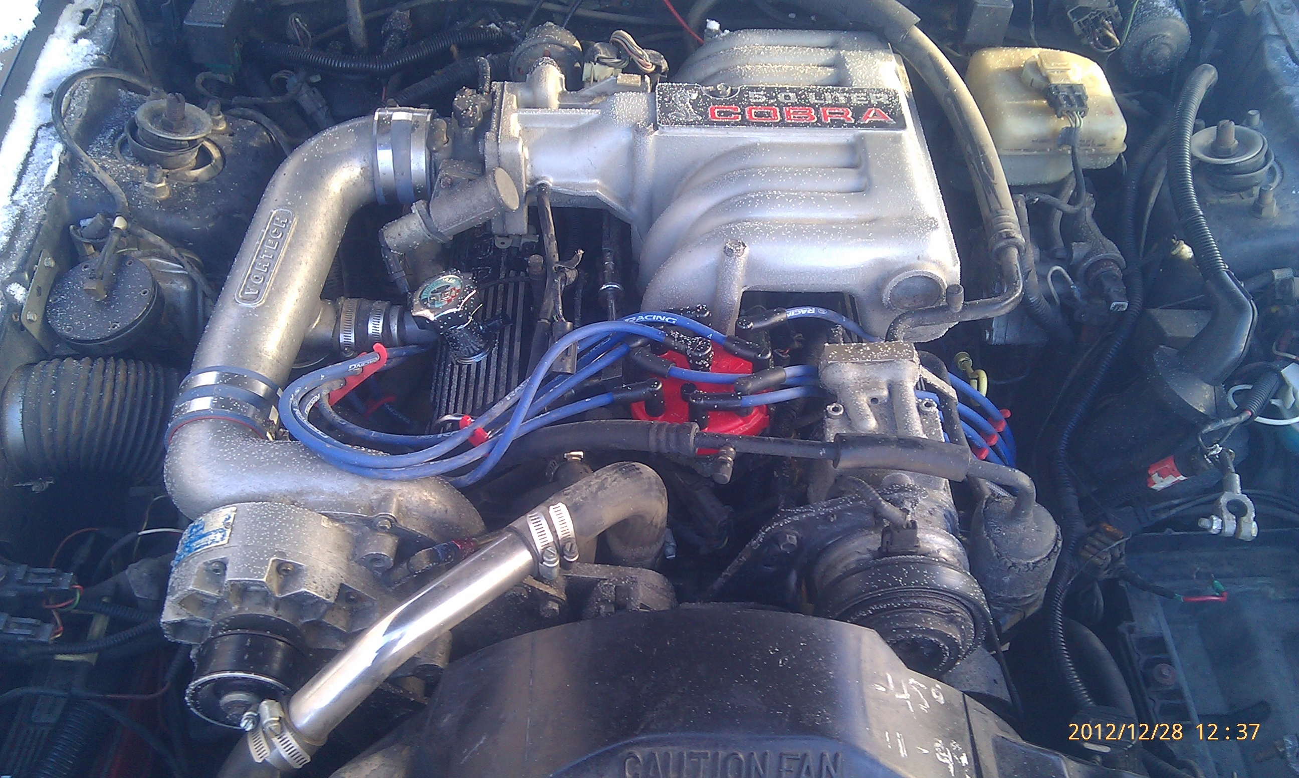

Ok. First I'll start with a little back story. I recently picked up a '91 Lincoln Mark VII. It has a Cobra conversion and a Vortech V-1 supercharger. I have a friend that is selling a '95 GT that I was thinking about buying. I was planning on taking the cobra topend and supercharger from the Mark VII and putting it on the GT, but I've been resourcing the different between the engines and found out that there are a few differences. I know that the pre'93 engines have MAP system and that the 94-95 went to the MAF. My question is how hard is it to convert the MAP to MAF? Parts needed? And I read that the drive systems are different on the two also. So would I still be able to run the Vortech SC if I converted to MAF and would I be able to bolt it up with the different drive system? If its alot of trouble I was also thinking of just getting a Foxbody Mustang to drop the 5.0 into. Anything advice that anyone could give me would be very helpful. Thanks

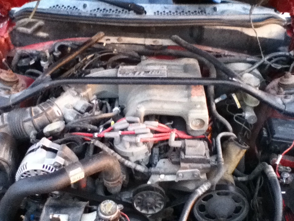

Also you need a 94/95 throttle body, which you could just use the stock one off of the 95 you're buying. The EGR valve is in a different place, attached to the intake manifold in a 95 and the throttlebody is further up the intake, after that elbow. From then you're probably going to do the fab work, I would just use angled metal.
The angle I think is the only real difference.
Here's a shot of a 95 engine bay, kinda blury:

I bought the Mark VII for $500. It was just too good of a deal to pass up. I can get the Mustang from my friend for a grand. The engine in the mustang has been tortured so I was planning on building a different engine for it. I was gona pull the SC and cobra top off of the MarkVII. Ive been looking at a stroker block from DSS, a rotating assembly from scat, and some twist wedge heads from trick flow. I got the install manual for both the 79-87 and 94-95 SC from Vortech. They look a lot alike but the brackets are different. My main concern is clearance. The fox kit relocates the alternator down by the smog pump, the sn95 mounts it up by the original location. I'm wondering if there is enough room to fit the alternator down there on the sn95? I heard that fan clearance is an issue on the sn95. I'm pretty sure I can just get a bracket for a sn95 but it runs about $500 and I dont want to spend that money if I dont have to. They also have an alternator relocate bracket for the drivers side but it runs about the same as a new bracket. Thanks everyone for your help and input.
