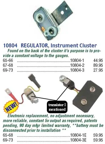

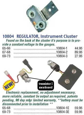

National Parts Depot has a listing for a '69-73 gage cluster voltage regulator in their '06 catalog. P/N 10804-3 and $27.95.
Edit:
See those "electronic" voltage regulators? It's just a Radioshack 5 volt regulating transistor with some wires on it. I can't believe they could patent it, let alone want $60 for one.
The transistor you can get for two bucks or less! Hell, I have a handful of them in my parts bin.

Thanks for all the great feed back, I had a feeling that there was another way to skin that cat.
Do you think I can test my old IVR by connecting a 12v car battery + pos lead to the pos terminal of the regulator and the - neg to the IVR housing and meter the other terminal to see if I get 5 volts output, or am I just running the risk of fring the unit.
It is conforting to know that you can build a subistute and that a new electronic verson is available if all else fails.
First and foremost, if you try the following and damage something, it was at your own risk and I am in no way responsible.
I'm pretty sure that the case of the stocker is grounded while one connector is 12V in and the other is 5V out. I do not know if the regulator needs a load on it to function. You might be alright hooking it up to a battery, but I also don't know if it gets any regulated current from the engine ba reg or just plain 12V power off the system. The electronic regs only handle about 1A so I assume the mechanical one can't do any more than that.
Just as I thought, NPD said that the standard replacement #10804-3 is not available but they do have the new replacement version in stock as a direct snap in.
Thank you again for responding, I now have my purchase source and a do it yourself option by 68Restoman.
Yup, i went through 2 of the "dtock" type at 30 bucks a peice because the tabs are soldered on and break very easily. It cost about $1.79 from radio shack and put some wires on it:nice:
