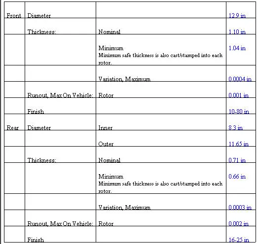

It should be stamped somewhere on the rotor. Check the attachment for the specs in the shop manual.
