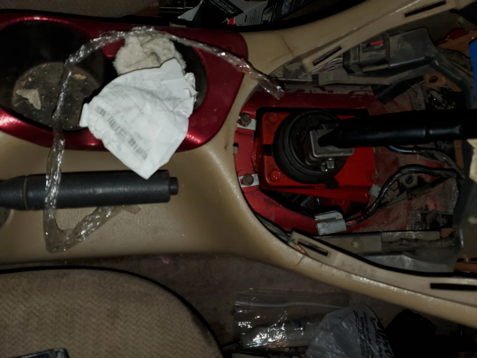

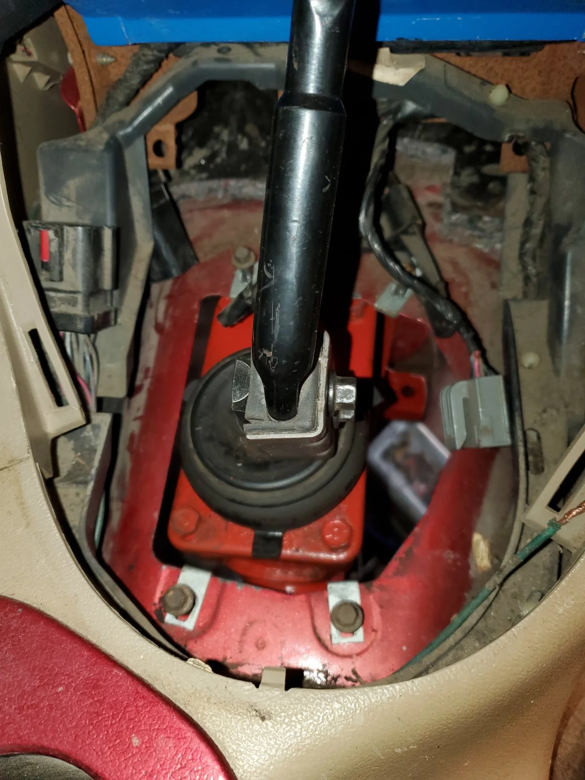

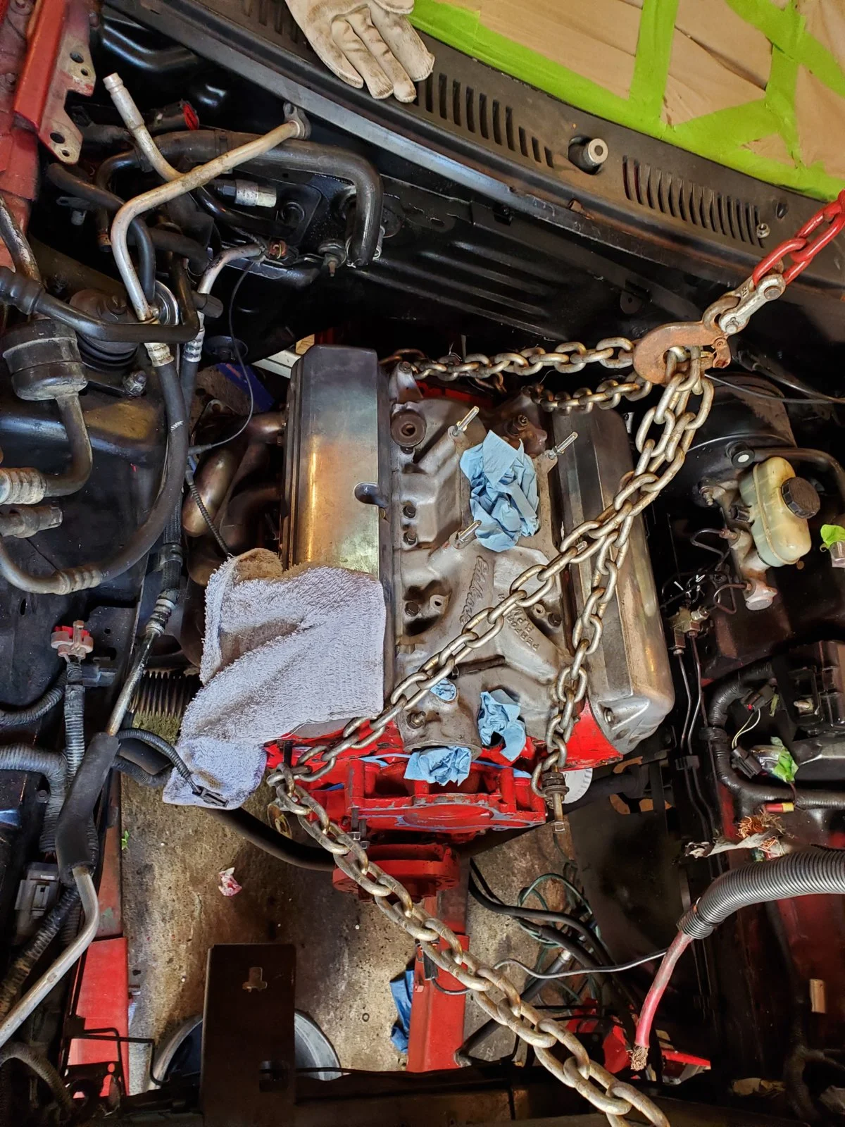

I'm in the middle of the swap and I got engine in (5.0) and transmission married to engine. However after dropping it in the car my t5 shifter won't go into 1st 3rd or 5th due to clearance. It's about an inch and a half short. Any suggestions? (Besides give up)

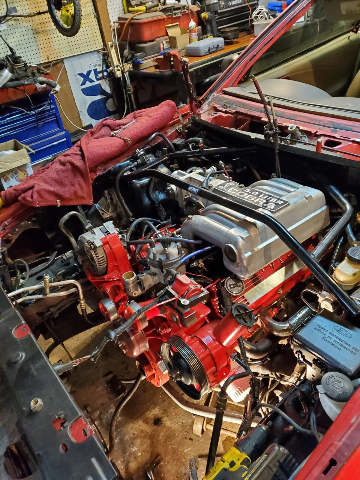

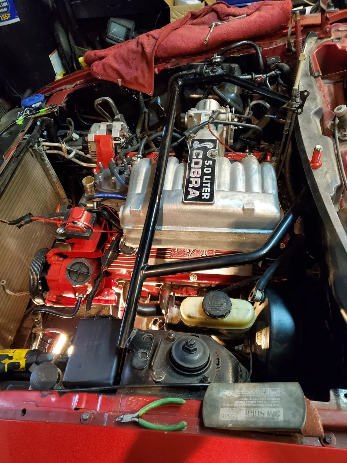

After searching for pictures in my phone I realized what I did wrong. The shifter was on backwards!!!!.... I have many questions to ask but in order to not bore you guys I'll search the forum for it first. I want to also say thanks to those that allow this forum to operate. So much information who need the performance handbooks???? Lol. I also put a picture up of my current progress as of 11-12-2019. Please n let me know if anything is off. I traded k-members with a 94 gt... 8.8 rear end... 302 bored .030 over.... 303 cam...looks like I'll have a clearence issue with distrubitor and breather..... any suggestions. Will be greatly appreciated.
