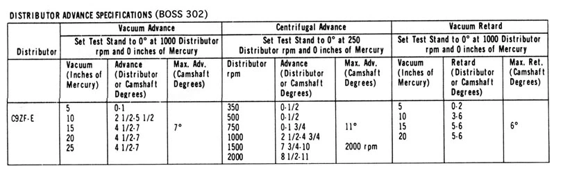

You'll need to get the distributor timing curves adjusted. These are always way off, and you're not going to be stock anymore anyway. I have seen many times engines that just didn't run right, turned out the advance curves were all wrong.
Unless you have a specific timing setup with the Edelbrock kit, just have the shop set your vacuum and centrifugal curves to BOSS 302 specs.

As far as the distributor timing curves that were mentioned, is this something that can be done at home with standard tools? It sounds a little complicated, is it something that your run of the mill shade tree mechanics could do? I am only asking because if I can't do it, then I was going to use my mechanic. Should I be looking for a dedicated engine shop to be doing this? Does the shop manual mentioned earlier cover this topic? Speaking of the shop manual, I found one on Ebay and it has been ordered! :)
