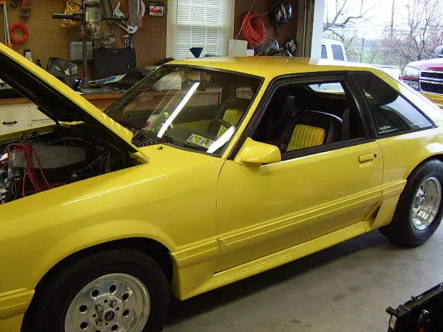

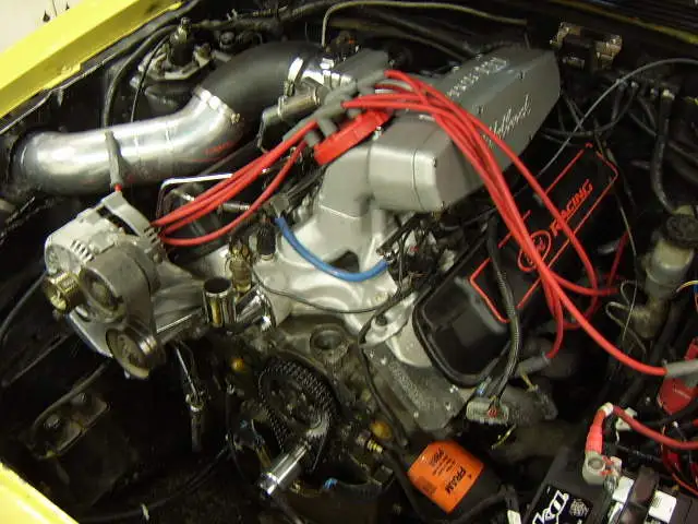

here's an idea...post pics of that motor and car! 427...

Cenok, here are some pics!

very nice looking car and engine my friend. How did you end up getting the springs you have? Were they the recommended ones from comp cams? If not maybe give em a call and have a chat with a techy. If they did recommend those springs then maybe talk to a professional engine builder.
