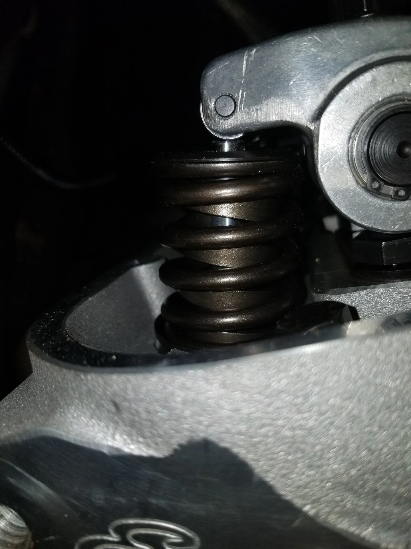

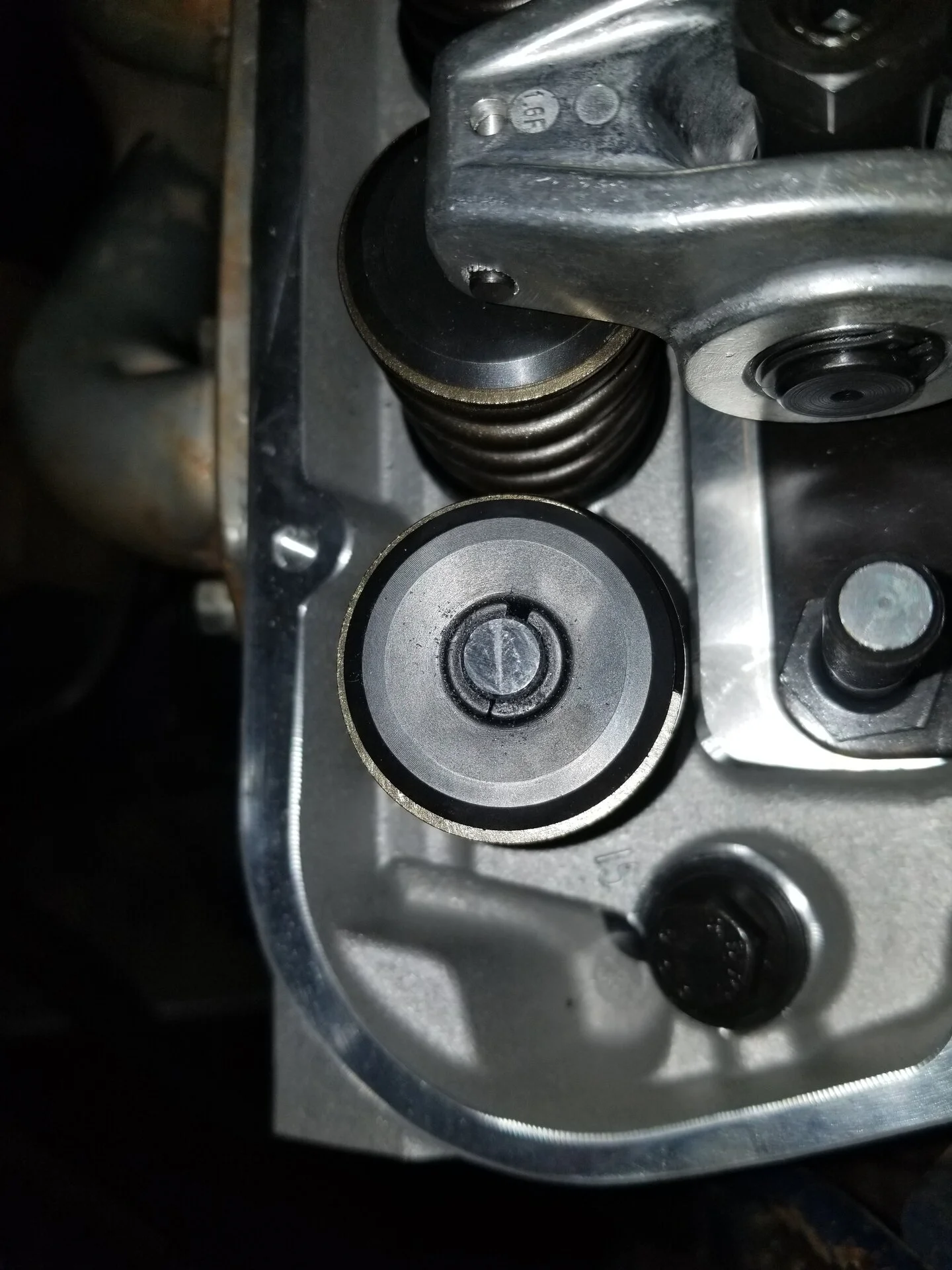

Here's a couple pictures, i coated the nub with graphite, attached the rocker and turned the engine by hand two rotations. Line is the contact point. Does this look good? First time doing this
