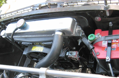

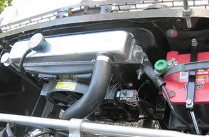

FWIW, I have a 2-core aluminum National rad with Hotrod electric fan/shroud cooling a built 331 (425-450hp). Since I got the thermal switch working properly, I haven't had an overheating issue. If you get an elec fan, pay attention to where you pull your 12V - make sure it is solid for both the motor and relay. Losing either is not good - ask me how I know. Because I have a MSD 7, elec fan, and one or two other switched 12V needs, I built a 12V buss near the battery with solid connections to power the relays. All good now. I made my own rad mounts from simple 90 degree angled sheet metal (stuff I had laying around - easily obtained) and common fasteners. Not hard, at all.
I have toyed with a big-block rad and enlarging the rad openning, but it hasn't proved necessary. BTW, I live in the inland SoCal area and see some hot temps.
Was yours just a standard 65/66 plug-in unit? My stock/retro old 2 core radiator had at least a few inches to spare on each side that culda been used by a radiator... does yours still have that?
I added a newer style (exits the opposite side as my original 69 351w) Milodon high-flow water pump... would that be crossflow (it was for late 5.0s).
If yours is working for a 425 hp 331 it oughta work for me.
