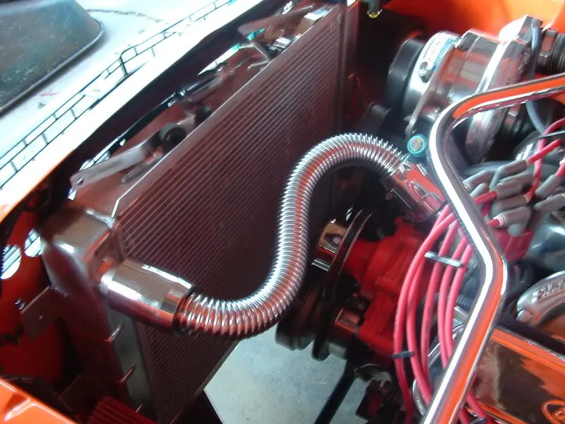

this how much i opened mine and also gave more clearance to the water pump.

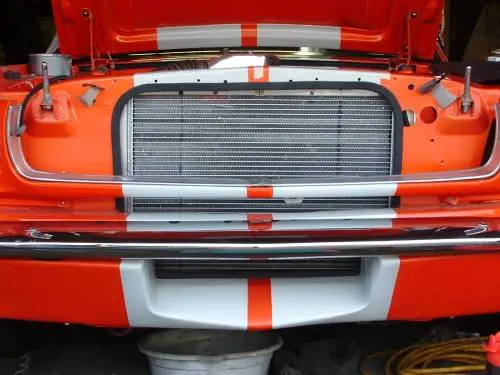

Here is a link to my install:
http://www.stangnet.com/mustang-forums/threads/northern-radiator-taurus-fan-install.698848/

how wide is that radiator? no fan? looks nice though :yup:
