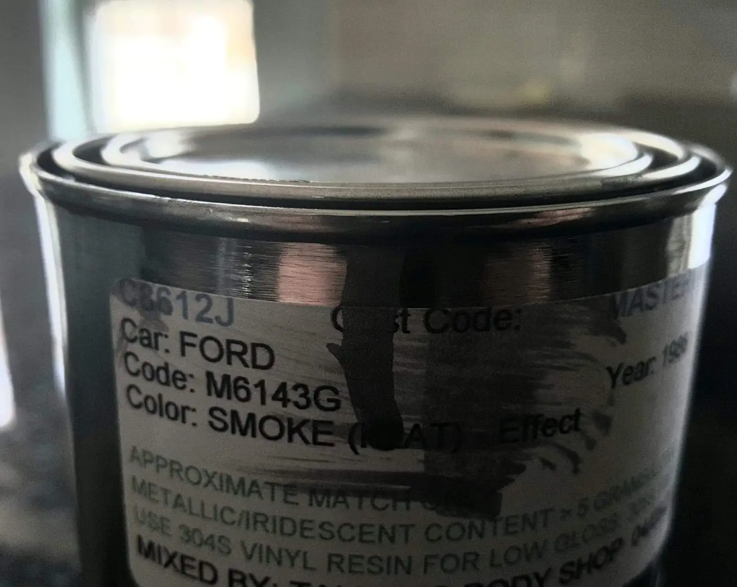

I have a 1987 5.0 GT. Typical 2 tone, mine is the dark charcoal up top and the silver lower. I know a lot of the two tone cars of that era had different color uppers, but that lower silver I believe to always be the same.
I picked up a ABS chin spoiler from Makers Garage and want to paint it to match the lower half of the car. My paint and body guy took a picture of the door tag which apparently only has the main color on it? I don’t know enough to say that’s true or not. Does anybody know what that paint code would be?

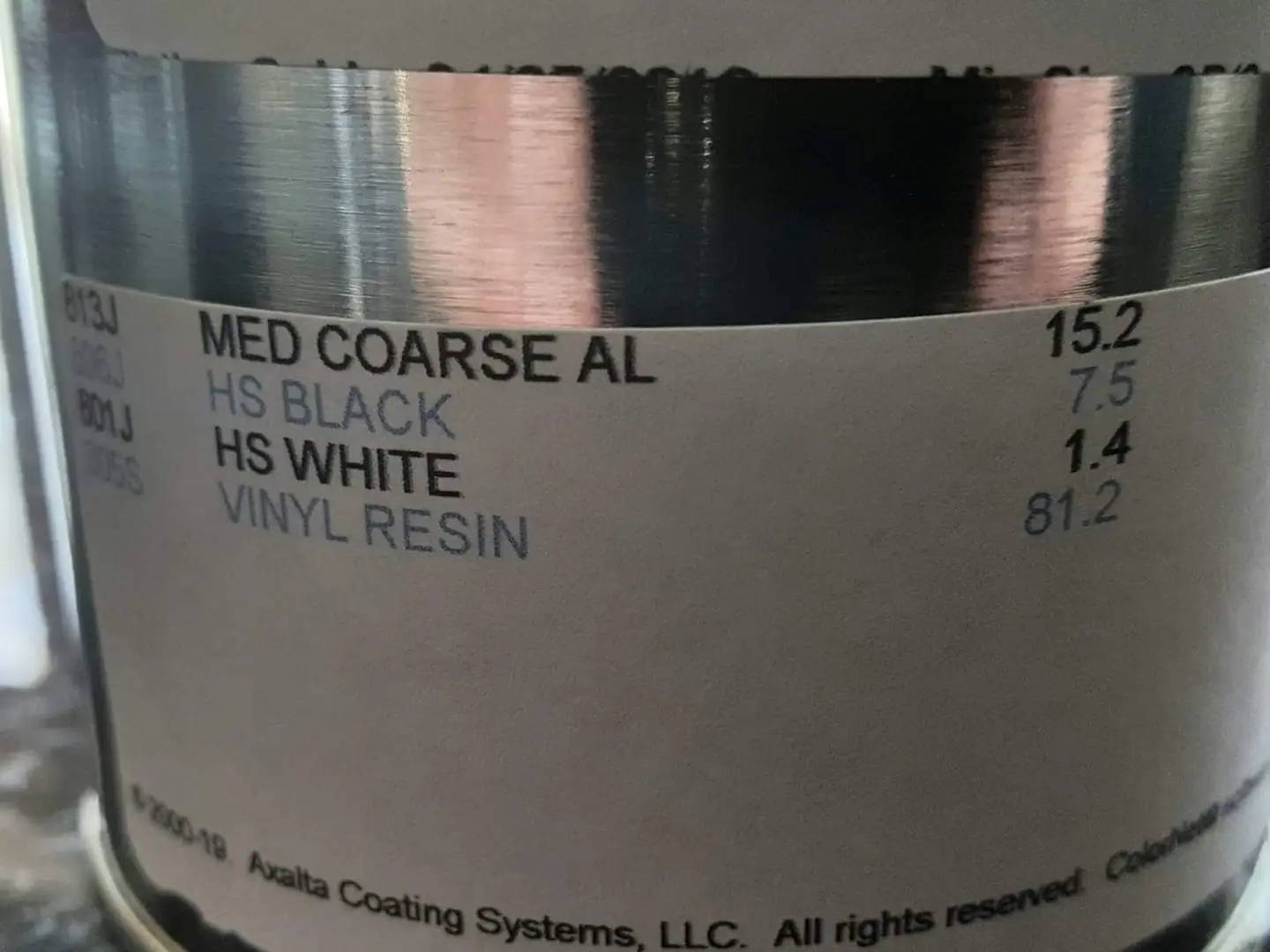

Mustang 'Lower Titanium Accent Paint' code on the door tag:
1987-88 = 73
1989 = 76
1990-93* = YJ
*for part of 1991 code ZH was also used
Ford paint shop code was M6143G.
