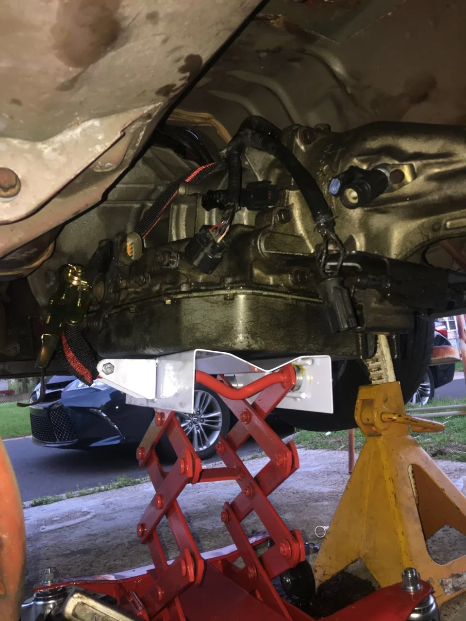

The Mommy-mobile is on jack-stands in my driveway. I went underneath there and there is a lot to remove. The h-pipe, the driveshaft, electrical connectors, shift cable, plus unbolting torque converter, etc.
Reactions: RaggedGT
It’s done. I’m driving it around. I don’t trust it 100%, but it will do highway speeds no problem. So far,.. so good. Tomorrow I am gonna use it to pick up my daughter... probably 50 miles round trip. Then work commute on monday... 65 miles round trip.
