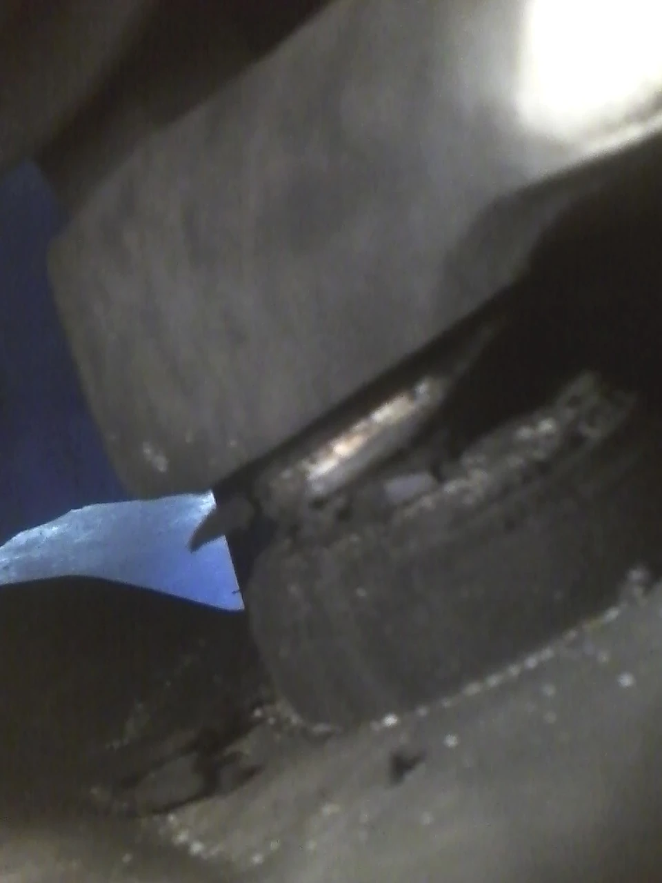

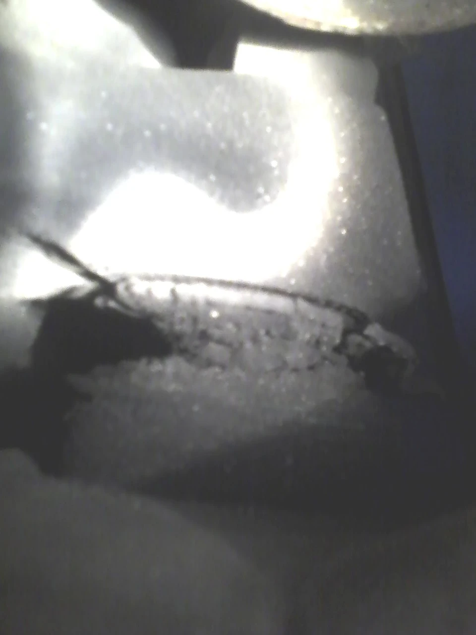

I will try and get some pics later on and post

the arms last forever if you didnt wreck it, its the balljoints and bushing that go bad. get some energy bushes and a set of moog bjs and install them when you do the struts/springs. alignment is not impossible to do yourself, i have done it on my 96 v6 on the 3rd try. got steering wheel and caster dead on center. just look down the front tire and align with the back tire and adjust as necessary. wont work with different tires from front to rear tho, back cant be wider then front.. cant spaced out from shaft. just make sure in the end you arent eating up tires.
oh i didnt see those pics before i posted but something doesnt look right about them. they look like they are falling apart lol. pic one looks like the ball joint and it has no dust cover. also looks like rubbed metal there. can you get better pics?
The rubber has gone bad for sure on the ball joints. Can't really tell too much with that picture of the bushings. I've tried to align my Mustang myself before, and not done well. With a Caster/Camber gauge it's not to bad setting the caster and camber, but it's hard to set the toe. The track on the front is wider than the track on the back with a Mustang. So you can't string it to get the toe set.

the ball joints are the ones that go vertical right? Those are the images I took. I will try and get better pics but hard with the lighting and such and car was in garage.
Yeah. The ball joints connect the control arm to the spindle.
