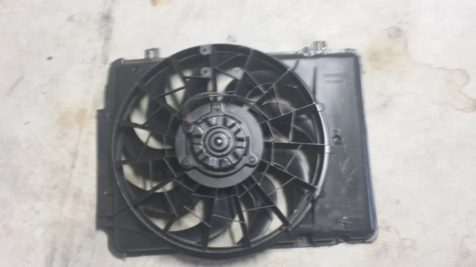

what is wrong with the stock clutch fan? They pull over 3000CFM. IF you decide to replace it, I would highly recommend
1. upgrade to a 130amp 3g alternator
2. get a taurus fan from a mid 90's v6. They pull well over 3000 CFM and fit perfect- see pic below.
3. get a Flex a lite 33054 fan controller
This will set you back anywhere from 200-400 depending on if you buy new or used.

Im currently running a 3g alternator so i got that part covered :p has anyone had any experiences with mishimoto rads and dual electric fans at all or am i out of luck on that? Keep in mind im also located in canada and its hard to find decent quality parts in the scrapyards out here that still work decently :p
