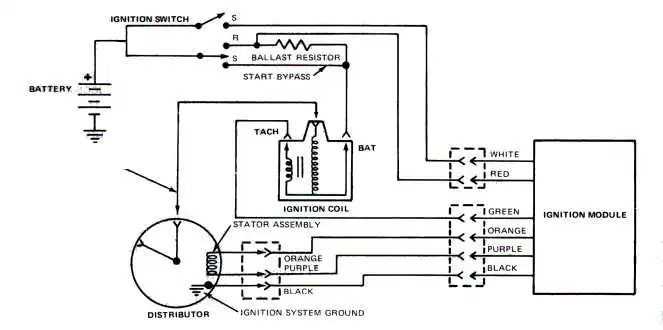

Probably this extract of the DuraSpark circuit will help:
The (-) on the coil is not a ground, is the collapsing pulse receiver to have the coil generate the spark, it doesn't go to a ground. You can check the pulse with a 12vdc test light, while the engine is cranking, it should blink, if it doesn't,... need to go back to the module, wiring, connectors or pick-up coil. GL

Saleen0679 said:
I remember you posted that diagram in his other thread, but it didn't seem to help.:shrug: :scratch:
Yeah, I noticed and remember that too. :shrug:
Provided voltage is ok, module passes (had it tested), the pick-up coil is OK, no connections or wiring problems are present, coil pulse is not present; the only small detail that could be overlooked is the small ground reference point/connection that is located in the distributor (ignition system ground).
