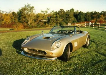

All - Didn't want to muddy up the waters with non mustang detail but, here is a little more detail about the car.
Replica of 1958 Ferrari Spyder California, built by me in 1987. The last of 11 "unassembled cars" produced by Modena Design and Development. Chassis #18. There were a total of approximately 54 sold before the company was sold. Total production from all owners was something on the order of 62. Yes, this is the Ferris Beuller car.
Frame - custom nasca style, designed by a nasca chassis maker (don't remember who). Chassis main rails are 3 x 4 box tubing, .120 wall with a 1" square tubing backbone that runs from just forward of the rear axle to beyond the radiator. From the rear of the back bone to the the rear bumper is 1" square tubing upper and lower frame.
Mustang II front control arms and steering rack. Carrera coil over shocks with Heims (sp) joints and Energy suspension poly bushings in the control arms.
Rear suspension is 4 bar (with poly hour glass shaped bushings) and a panhard rod, Carrera coil overs (same as front).
Power (up until this summer) was 1974 351 W. .030 over, Edlebrock performer cam and intake manifold. 1984 Bronco electronic distributer, Holly throttle body EFI (commander 950) Sanderson block hugger headers, High flow cats, Dynomax mufflers.
I'll attempt to attach a photo.
Doug

I don't know about the others but I'll forgive your killing a II to make this car.
attachment.php
:nice:
I thought you were going to say something like a Classic Mustang, or a Camero or Streetrod ... killing a II for one of those is BullShyt.
Mustang J - Unfortunately ... it is on Jack stands at the moment and expect to be for approximatly one year. As mentioned, on the front end of a year long restoration/upgrade. Sadly, The 351 is gone .... BUT .... I have a Thunderbird Supercoupe engine/trans that will take its place The 351 will have a new life in a FFR Cobra by the way. :nice:
Wart - I do have another Itsy bitsy confession, the paint is 1987 Corvette Silver Beige. That photo was taken in the early, early (read that as O dark thirty) morning sun. And, the steering column is Pontiac GTO (1967). Everything else is aftermarket of Ford. I swear it, honest.
