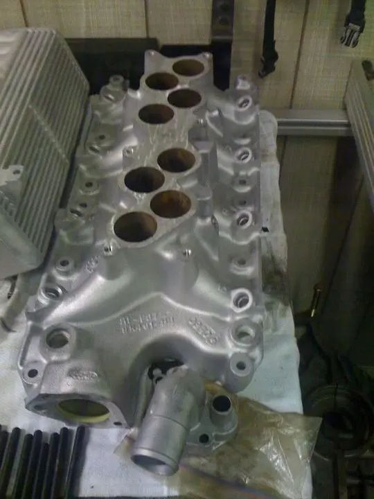

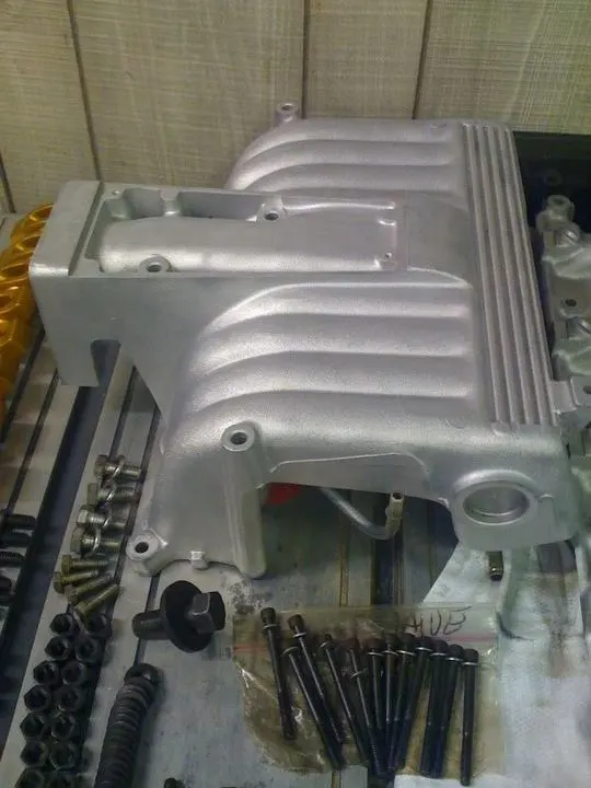

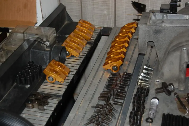

Ok so today I picked up a ford racing B303 cam to go along with my other stuff and I need help deciding what heads to get. Ok so far I have theese waiting to go in.
GT40 Upper and Lower Intake(explorer)
B303 Cam
1.6 Crane Rockers
2 Different length push rods
Already on the car that would swap over
Professional Products Throttle Body
C&L Mass Air Meter
BBK Long Tube Headers w/offroad h pipe, flowmasters(I think it's 2.5 exhaust)
Soon to be
Either 3.55 or 3.73 gears
So originally I was thinking of getting GT40 heads but some people say I'll get more out of it if I go with something like AFR or Trickflow. As far as cost I only have $155 wrapped up in the stuff not on the car including the cam, so I am really budget so far. Can I stay on a budget and still run 12's? Keep in mind this is a street car not making it a drag car, it will mabye see the track 5 times....
