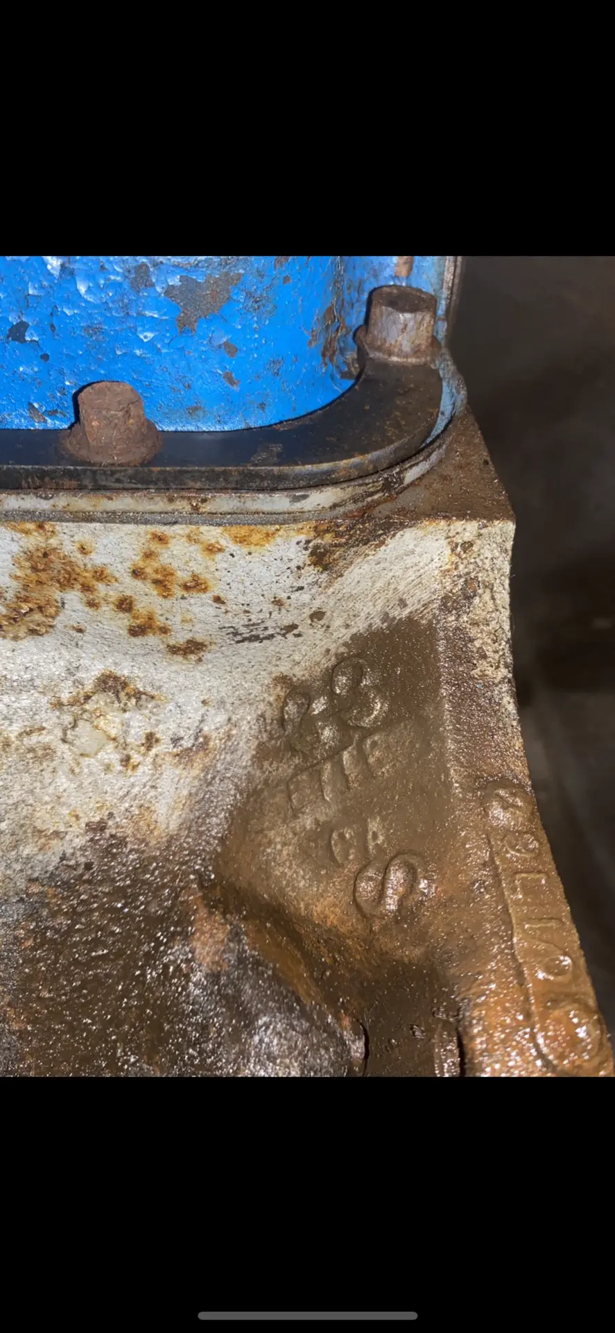

I have an 83 stang I bought from someone and he put a 302 in it, I’m trying to decide what exactly the block is, I found behind the starter it says 23 E7TE CA S and next to it, 9L10. What do these mean? I have found a lot of conflicting information online. Is it even a 302? I pulled valve covers and there were no head stampings I could see.

Ok. Does L stand for the 80s? And how do I determine if it came from a truck or a car?
9L10 breaks down like this
9 = last digit of year. Could be '79, '89 or '99. Since it's an E7 block, that rules out '79, and the E7 wasn't being made in 1999 (they switched to F1SE then) so it's 1989
L is the month. 2 letters aren't used (I think I is one of them) so L is November
10 = 10th day of the month.
The E7TE block was used on trucks and cars from '87 to around '90. It could have been in an F150, or a crown vic. You'll need to look at the pistons to really know what it came from as some were dished, and some had eyebrows
