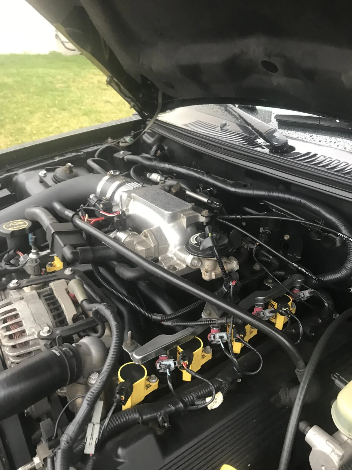

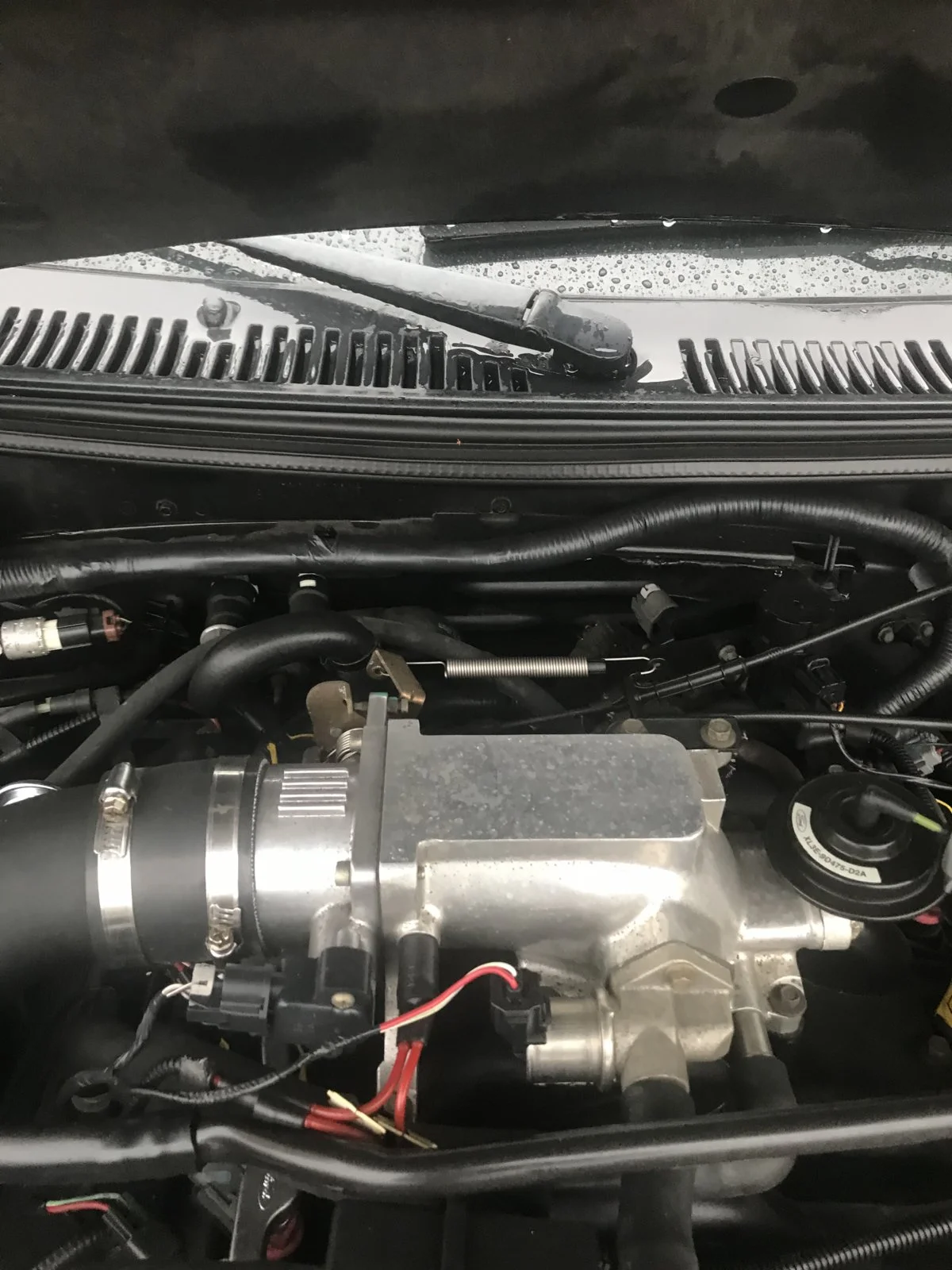

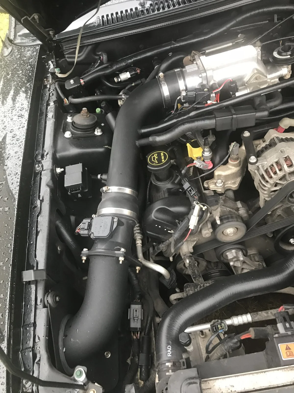

Engine Need help identifying the mods done in my engine bay please (throttle body?)
I purchased my 2003 Mustang GT 2 weeks ago from a garage nearby for what I decided was a good deal. I can see the car has quite a bit of mods done to it from what I can tell, I've already concluded that it has long tube headers, catless x-pipe, and a catback. Along with 17 inch black bullit wheels and lowering springs. However I'm having a hard time figuring out what mods are done in the engine. I can see it has an intake already however I can't see any branding on it. I can also see some ignition coils. It looks to me like the throttle body isn't factory but I can't figure out what's done to it and neither could the people I bought it from. If anyone could help me identify what throttle body I have it would be appreciated because I plan on getting a Bama Tuner for my car this summer. Pictures of my engine included.

Hi, I’d started listing off some MFG’s that looked familiar, had to interrupt & lost my text. Apologies!
Your 4.6l (PI) SOHC’s Cool Air Intake, 70-75mmThrottle body & Plenum look like SR Performance parts, with an added larger 80-90mm BLACK Mass Air unit up front (possibly off the Ford Lightning or an 03’-04’ Supercharged Cobra).
SR products are sold near exclusively by American Muscle, as Combo’s, with the CAI, TB, Plenum (86’-95’s w/5.0 H.O. motors get a Spacer for the EGR Vs the 96’-up 4.6L’s getting the Plenum) take a peek on their site- compare pic’s to AM’s. LMR also has a similar setup, under a different MFG. With Intakes in view, compare any subtle differences with your CAI. Your Coils are ACCEL’s, visible labels on each COP. AND Accel’s been using Canary yellow since the 60’s on Ignition parts, lol!
The 3 notches atop the TB is the 1st clue. Absent GIANT brand name is the 2nd. Your large MAF is one used typically for a Forced Induction Motor, or motors that pull a lot of air due to high flowing Heads, aftermarket Intake manifold, with Higher-lift, decreased Intake/Exhaust lobe C/L, radical Cams, L.T. Headers, Bigger Injectors, Fuel System & a stout Reciprocating Assembly, I.E. Steel Crank, Stronger Forged I Beam or H Beam Rods, Forged Pistons & ARP Stud’s, fasteners (or equivalent) to hold it together. They CAN, however- be TUNED to run with ANY build, Won’t run right without one. Car May even have a DYNO Tune...Does it run Ok, just seeking some more Ponies for your new Pony?
A Datalog would reveal a LOT about the build to a local Tuner, or by an SCT Tuner to BAMA. Their “Tunes for life” includes Datalogging, and Tuners have the ability to Tune AND Datalog. I’d contact AM, or better yet- SCT -BAMA directly to find what Tuner type BEST suits your desires..
The 96’-01’ Cobra’s, 03’-04’ Mach1’s were built with the Better Block, Internal’s, &, Stronger yet, the 03’-04’ Cobra’s. You’re reliably limited to around a 425-450 HP build with the OE Motor you have,- providing it’s not an ultra high Mileage, beaten to death Motor, Do Compression testing, pull off a Valve Cover & see how it all looks.and BTW- 425HP -that ain’t BAD!! Motor appears like it was taken care of. Check the other stuff.
I’m just giving you facts, not ranking on your Ride. Looks like a good find!
There ARE ways you can find the Owner, previous to the Dealer who seems to have limited info., but ALSO keep in mind it may have been RePosessed, & sold off at Auction...
As the Pic’s show, it’s running the Stock PI Intake Manifold, it’s quite restrictive- but I’d had a NON PI 96’4.6L once, with the stronger T-45 (5) Speed. 96-98’s (NON-Pi) VERY RESTRICTIVE Intake & Heads & I’d repeatedly sprayed with 150HP wet NOS shots, it had bolt ons- & Cams, 130K & still Ran GREAT!
The 4.6’L 2 Valve motor’s ARE resilient, like anything else, as long as you don’t go overboard!
Your RED Injectors MAY be Bosch III EV-1’s (30lb’s). You need to spin one & look for Part#’s, or depressurize & pull the Rail & remove one to be positive., ALL 86’ & up Stock Ford Mustang GT’s Injectors were Yellow EV-1 (19Lb) units, until 05’s 3 Valve SOHC 4.6L GT’s came, then to (24Lb’s). Cobra’s & other certain models excluded...
OE Ford Injectors are Color Coded, and in (3) general injector designs, (EV-1’s are wider in design, others types are Narrow, different connector types) i’m listing the 5.0/4.6L GT’s- Ford ALSO used them in many other Vehicles, 19-80Lbs/Hr. Conversion kits allow usage of each type in any EFI application. Many aftermarket Injectors are available:^^ EV-1’s (Jetronix, Minimeter*) 87’-04’ OE: 5.0’s in GT/LX, Bullitt) EV-6’s, (USCAR) 05’-10 GT’s, & EV-14’s (USCAR) 11’-up GT’s.
* Bosch/Amp Connector types.
^^ Referenced from A.M.
Hope this information at least points you in the right direction! Any questions & people are certain to pipe in. Good luck with your new Ride!

Wow, thanks for the very detailed and lengthy response, I'm pretty new to Mustangs so I'm still getting used to everything and learning things. I confirmed what you mentioned that my CAI, Throttle Body, and Plenum all match the SR Performance ones from American Muscle. Thanks for pointing that out to me. The MAF you pointed out matches the 90mm one from American Muscle. I never would have noticed that otherwise so thanks. Now about the fact that it might be tuned, the garage I bought from said they believed it was dyno tuned considering all the mods it had and the fact that it had no handheld tuner. However, the Service engine light is on and when I read it, all the codes came back to was the rear o2 sensors. I thought that any tune would disable the rear o2 sensors so that sort of led me to believe it might not actually be tuned, also when I ran 87 octane and 93 octane gas, I couldn't notice any obvious difference with how the car performed different with the 2 different octanes. I also installed MIL eliminators but the code came back on anyway so I guess those were a bust. The car does seem to run and drive fine besides the fact that it smells of gas when idling and that I sometimes hear pops from the exhaust when idling. Might possibly be running lean? I'm not too sure myself if those are bad things to have happening. I've also had an issue where sometimes the RPM's would drop to around 200-300 and rise back up to 600-700 repeatable for a little bit and then eventually stall out. This has only occurred when the car is warmed up however. I'll be bringing my car into a ford dealer soon to see if they can do anything to fix the idling problem that sometimes happens when the car is warmed up. As far as the injectors go, I don't know much about injectors but I'll look into it more to see if they are actually upgraded like you had mentioned they might be Bosch III EV-1’s (30lb’s). I also don't know much about Intake Manifolds and they do seem a bit pricey and I'm not sure if I would really see much of a performance upgrade from buying a newer better intake manifold. My only real plan with the car was to get a tuner to get the most power I can out of the current mods I have, and I also wanted to get a short throw shifter since the throw is quite long. I followed a youtube guide to see my rear gear ratio and I came back with 3.27 so I concluded that the gears are factory, however I don't plan on upgrading those as I am a bit short on money as a student right now. I believe I would need a tune for a new gear ratio as well since the speedometer will be off. I don't know of any Tuners near me (Eastern Pennsylvania) that could perform a dyno tune for me or even data logging to help me see what is actually all done to the car and what power its making and it's A/F ratio. However when I was driving the car around on some back roads it definitely was making more than 220 to the wheels from what I could feel. However I greatly appreciate your response, it has been very helpful, and if you do happen to see this post and you have anything else to add that could help me I would greatly appreciate it. :)
