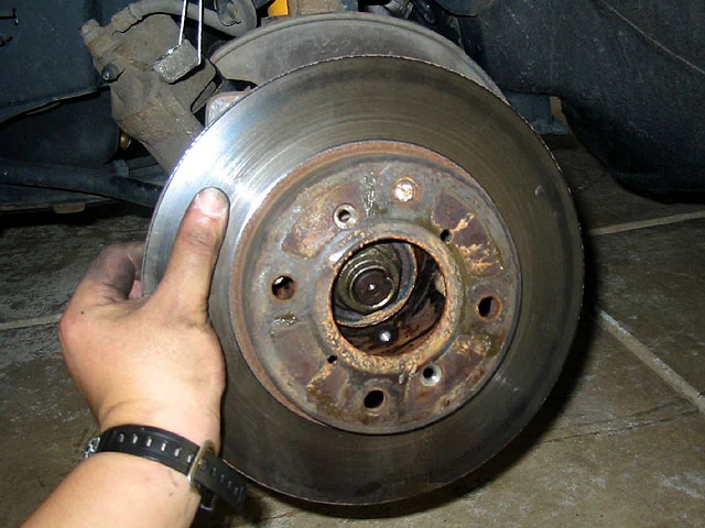

My rotors came off pretty easy. I tapped the side of the "hat" on the rotor and it sprang loose. Just give that part a couple taps with a metal hammer. Do not pound the backside of the rotor unless you have a plastic face dead blow hammer.
You could also spray some PB Blaster in the crack where the rotor sits on the hub.
Here's a pic

Thanks for the info. The tapping worked, we finally got them to come off, just the drivers side so far, now on to the passengers side. Thanks again.
