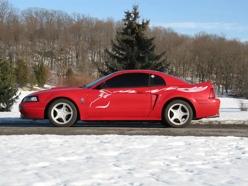

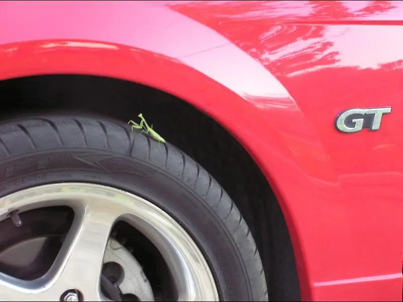

Depends, the older sn95 guys can have a good low drop on anything. even prokits look low on 95-98. New edge-I say sportlines. I had FRPP and IMHO what a waste of damn money. They rode ok i guess, but it didn't really drop the car. Theres a thin line between 4x4 and regular. FRPP, Steeda, w/e only drop it JUST enough so it doesn't look like a 4x4. However- that does not mean no wheel gap. you'll have a whooolle lot of wheel gap with FRPP- bery noticable and IMO ugly. Walk up to any other car on the road and it'll have less wheel gap than a mustang lowered on FRPP.
I then got Eibach pro kit. Again- another mistake, although 100,000,000 times better than FRPP- still had wheel gap, and the rear looked bad IMO, the car looked lower, it was harder to get out of and stuff, but still had wheel gap.
The sportlines were perfect- with one problem, it drops the rear a bit more. Nothing to do with sagging, just the nature of the beast. Actually- it doesnt, it drops them DEAD even- it is 1.8 and 2.0F, however, the front and rear dont sit the same stock, so with sportlines- the front and rear sit almost dead exact even, BUT- because of the design of the car, and the way the front fender/wheel well is manufactured, the back end will look a little lower.
So- IMHO, the best spring to go with is Sportlines w/o front isolators. then the front will sit noticably lower, and you'll have a light, quality rake.

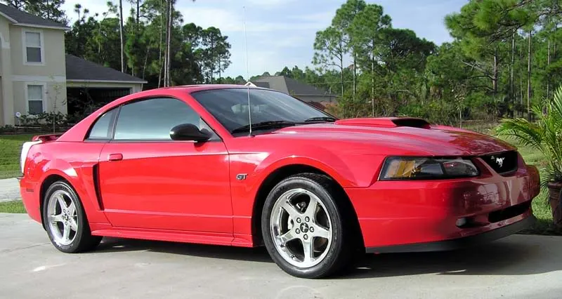

My mom has HR Super sports on her 03, and i like them too, and shes happy with them, but they don't sit as nice as the Sportlines. The front and the rear are still to high, and when you see the front end from an angle- the fender makes it look like it sits high. The rear was also on the high side (for my taste) so we put some 255 45 17s, and added about 3 tenths of an inch to the overall diameter and now it sits a whole lot better. you really gotta see drops in real life because pictures can be decieving.
