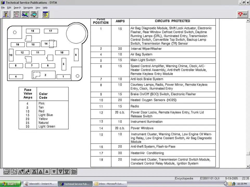

I may not be an expert on the track regulations, but I'm reasonably sure that you should use the kill switch to kill the fuel pump. This can be done easily by splicing into the wire that goes by the driver's side kick panel, its the dark green/yellow wire (hopefully your switch can handle high amperage, otherwise you'll have to wire in a relay). You could also wire this switch up to kill the coil as well by splicing into the red/light green wire coming from the 20A fuse under the dash (not sure what fuse # it is, you can look it up). This is just what I would do, others who have actually done a kill switch can chip in here and correct me if I'm wrong.
edit: I just looked up the fuse #, its #18 in this diagram:
