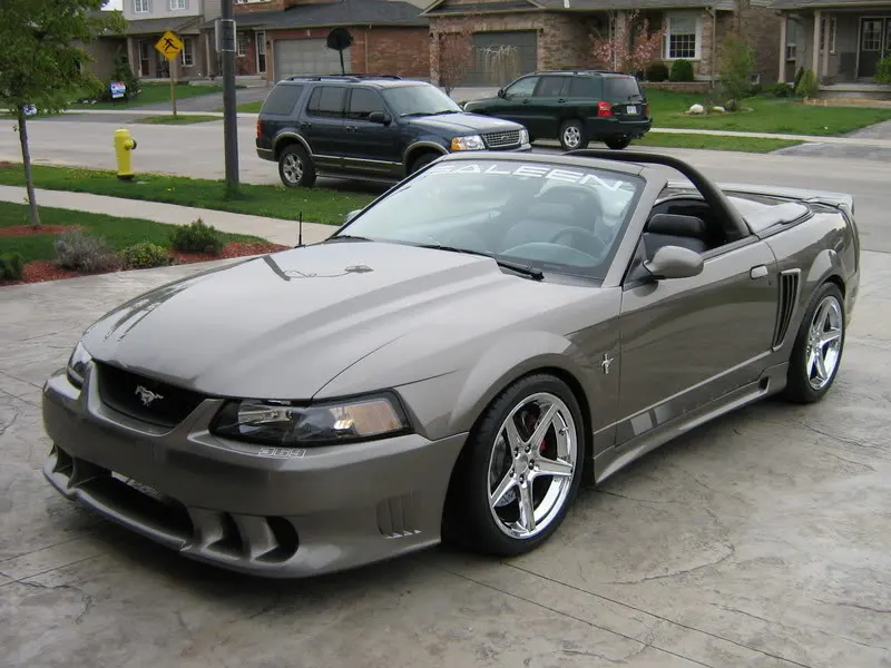

what do i need to do to make the shelby brambo callipers and rotors to fit my 01 mustang?,it has saleen wheels in it now.....
