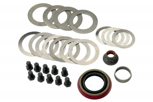

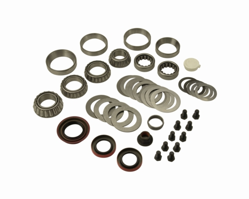

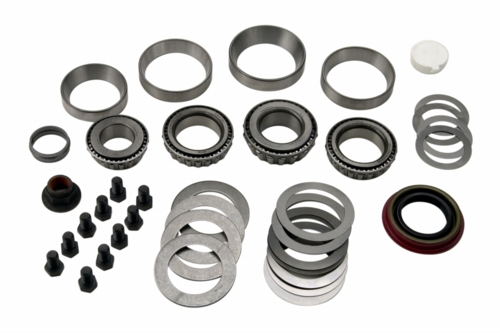

Read this: http://www.corral.net/tech/drivetrain/gears.html
You will need an inch pound torque wrench to set the preload on the crush sleeve and a magnetic base dial indicator to check the backlash.
Ford Racing sells three levels of installation kits:

svttech76 said:
UDT, you need the first kit in the pic that killy posted. it's the smaller of the ford kits.
the other kit you posted emilinates the crush sleeve but I find it easier just to use a crush sleeve.
