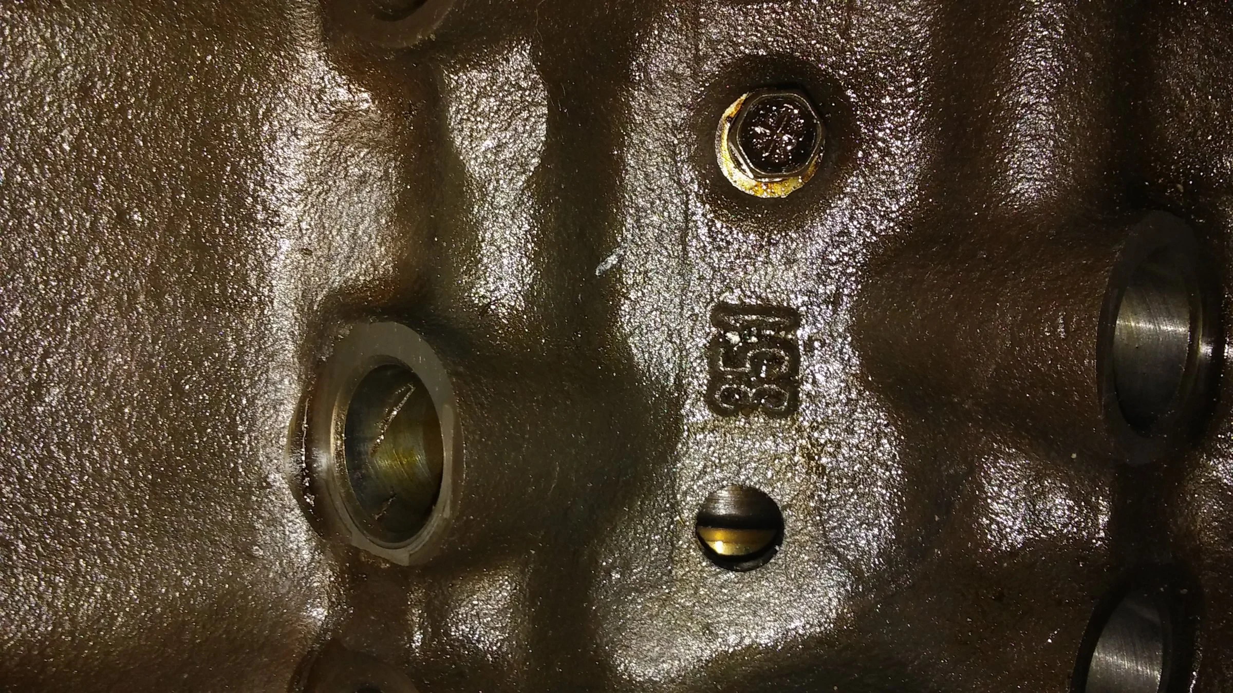

Ok i picked up a 1995 351w for a heck of a deal, and just went through and freshened up the motor. I did a stock rebuild with hyper pistons and a larger file fit ring gap, and a looser bearing tolerance for the boost application that will be fitted during the winter months. But for now just a carbed n/a motor. So here goes the thrilling question! I understand that a 351 is 28oz imbalance and a 5.0 ho is 50oz imbalance, going to a t5 I am buying a 157tooth 28oz imbalance flywheel. But I still have the original 351w balancer which is stock. Can I use the stock 351 balancer when using the new bought 157tooth 28oz flywheel? Every time I look at the 351w swap it never states can use stock balancer just says buy new or rummage one up from a pre 1981 302 which is 28 oz. I just need correcting info so I can continue or start shopping. Any suggestions would be greatly appreciated.

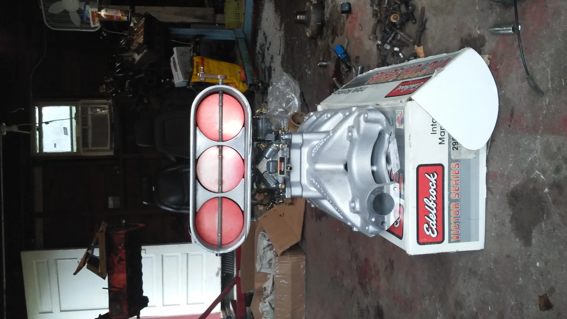

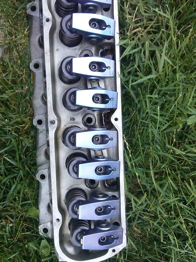

Gonna run stock bottom end aluminum gt40 heads 1.6 rrs anderson n41 cam victor series intake and 750 holley dubble pumper the mr gasket butterfly might not stay i think its cool though. I have a stealth set up too though. Thanks yall take care
