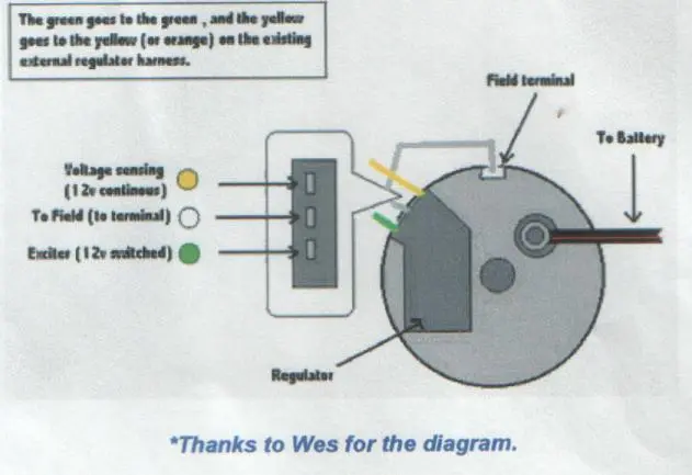

ok first off lemme say i highly recomend alterstart (ebay) they sent me a 3 page performance review of my alternator. max amps 169.1 max volts 14.78
but anyway ive got everything ready to except this, the little wire... where does it go? just to key on 12v source?
bracket had to be grouns into a bit :rolleyes:
sorry about the phone pics but im in a hurry.
