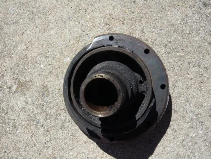

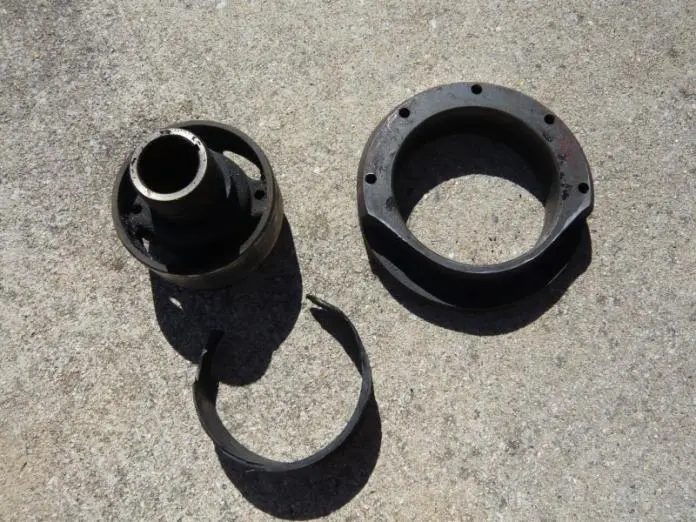

Take a very, very, close look at the HB. What you are describing is a spun balancer. On the engine side check to see and feel for any rubber protruding between the inner and outer hubs. Have you noticed any vibration? If it has spun it needs to be replaced like yesterday.
Or how mine looked:
