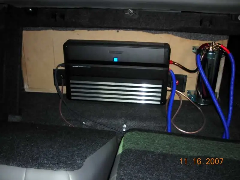

all that was like $400 shipped from Crutchfield. I already have a awesome alpine deck, 200w PrecisionPower 4ch amp powering some Kicker components all around, but the guy before installed bass-blockers so the car had zero bass when he removed his sub/amp and sold it. i am pretty satisfied with the system, sounds great for my needs, doesnt add much weight, the amp is attached to the box and can be removed by taking out two screws.

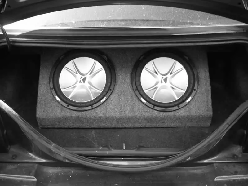

2 12" Kicker 07CVR122 DVC 2 ohm subs
Custom Homemade Sub Enclosure

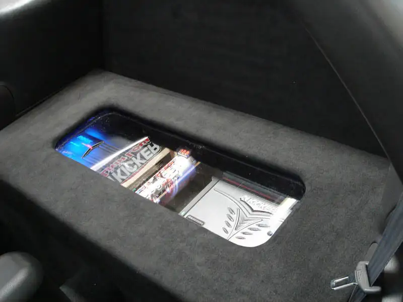

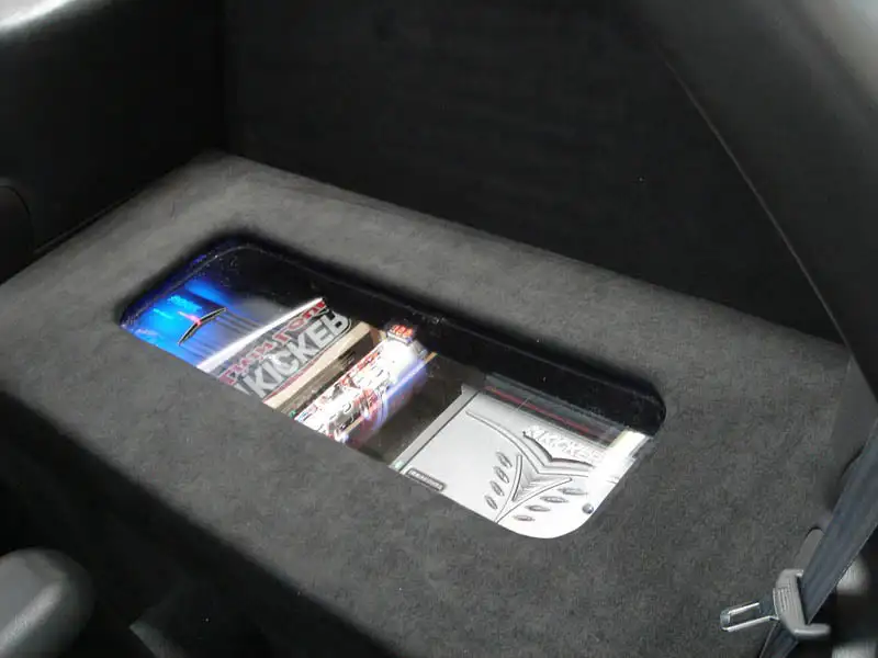

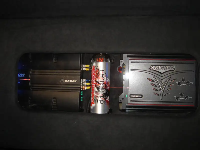

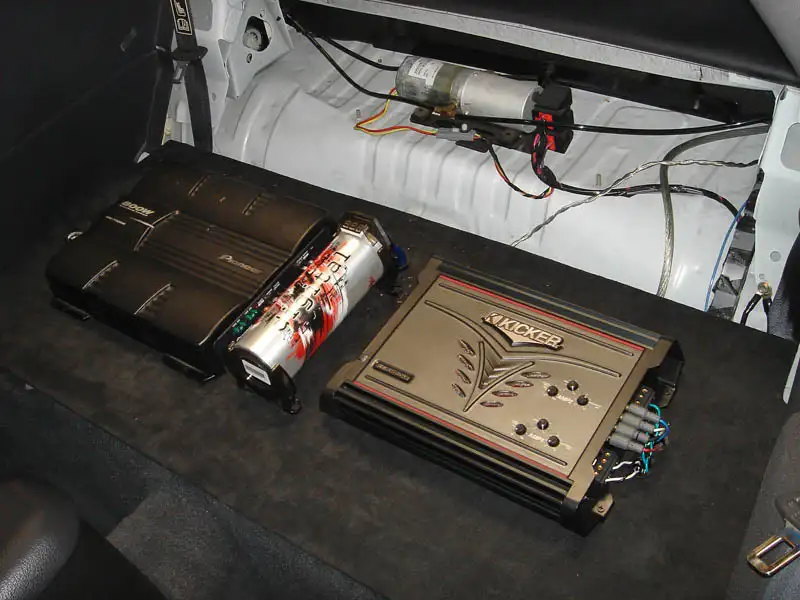

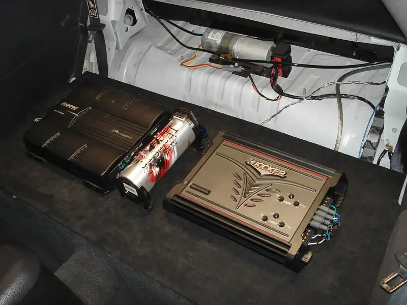

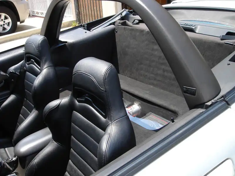

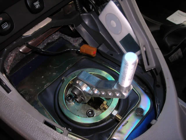

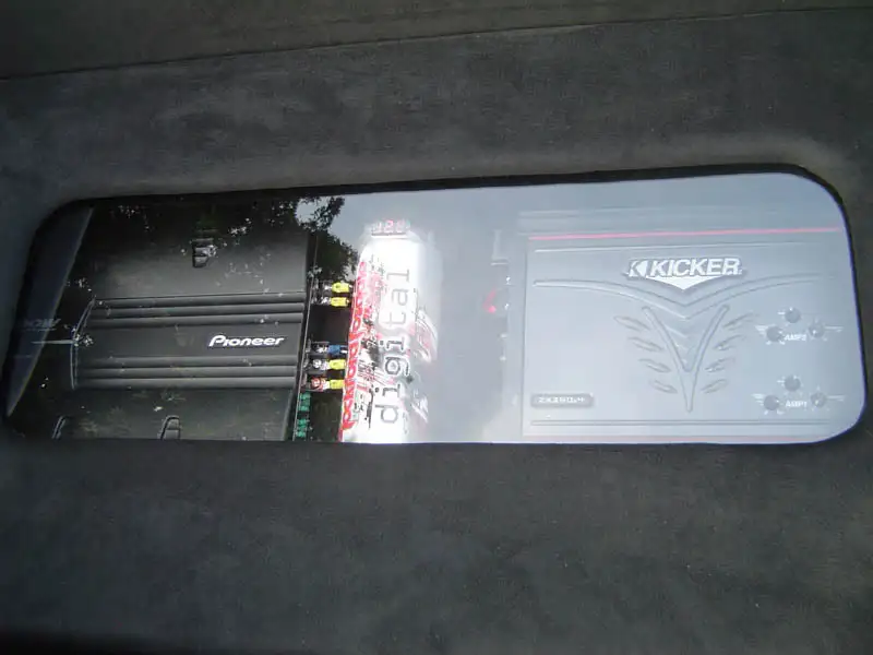

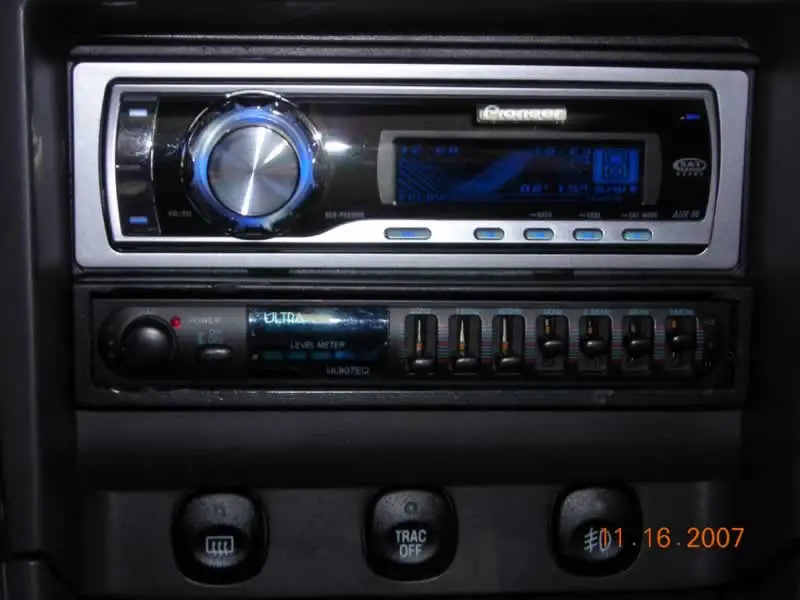

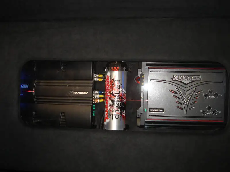

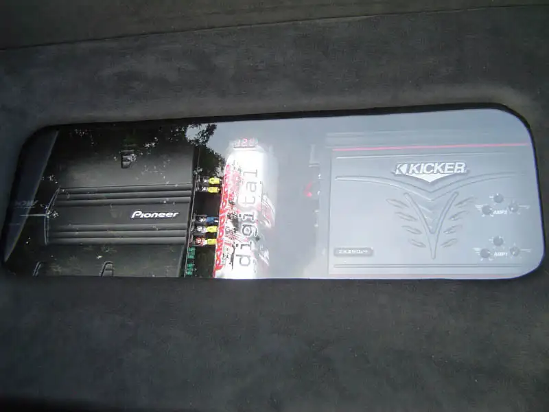

I went with this setup shown below:
Kicker 4 channel amp (power the 4 inside speakers, convertible)
Pioneer 800 mono amp (for the subwoofer)
Rockford Fosgate Capacitor (used fuse box to connect capacitor to BOTH amplifiers)
Optima Yellow Top Battery (deep cycle battery to handle excessive power drain)
Case made of wood, covered in suede, and plexi glass for display
(blue lights under the case for excessive bling)

And that is a clean looking system Saraphitia!
