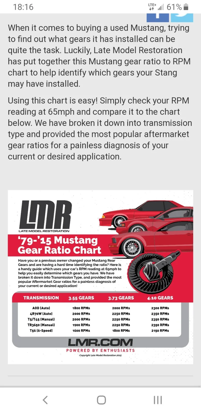

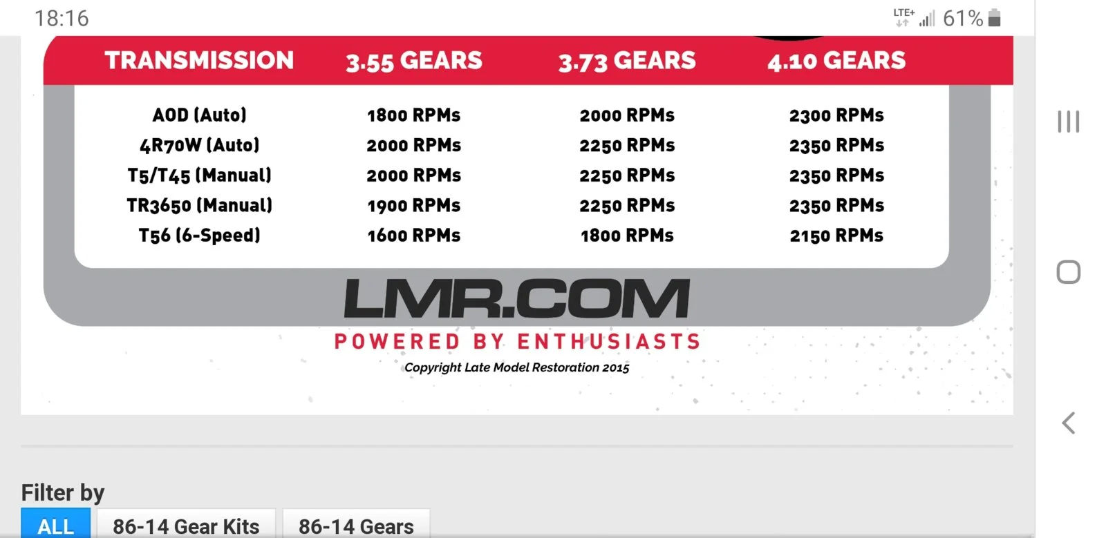

any website that can verify what RPM's would be with gear change, tire size etc etc. I am also looking to redo axle but need to verify RPM with gear change, don't want to install and I don't like car revvving to moon on freeway speeds and ask shop don't like gears. Can you change to another gear and he gives you second bill for $1K LOL!!!!
