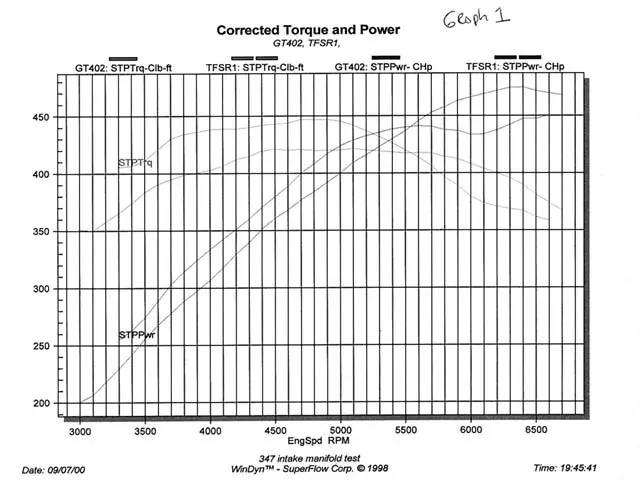

2Tone5.0 said:
well guys in general its not worth buying the cobra intake for the price and performance return. any other intake like the trickflow, gt40, and ssi are woth the price for performace return over the cobra intake. I'm getting the trickflow intake (because i have trickflow heads)
You do know the cobra and GT40 are very similar and post very similar flow numbers, right? I do mostly street driving and I'll take the better numbers under 5500 rpm than having a few more up top.(PS. I have trickflow heads too. I'm going to have tmoss port the lower intake to match up)
