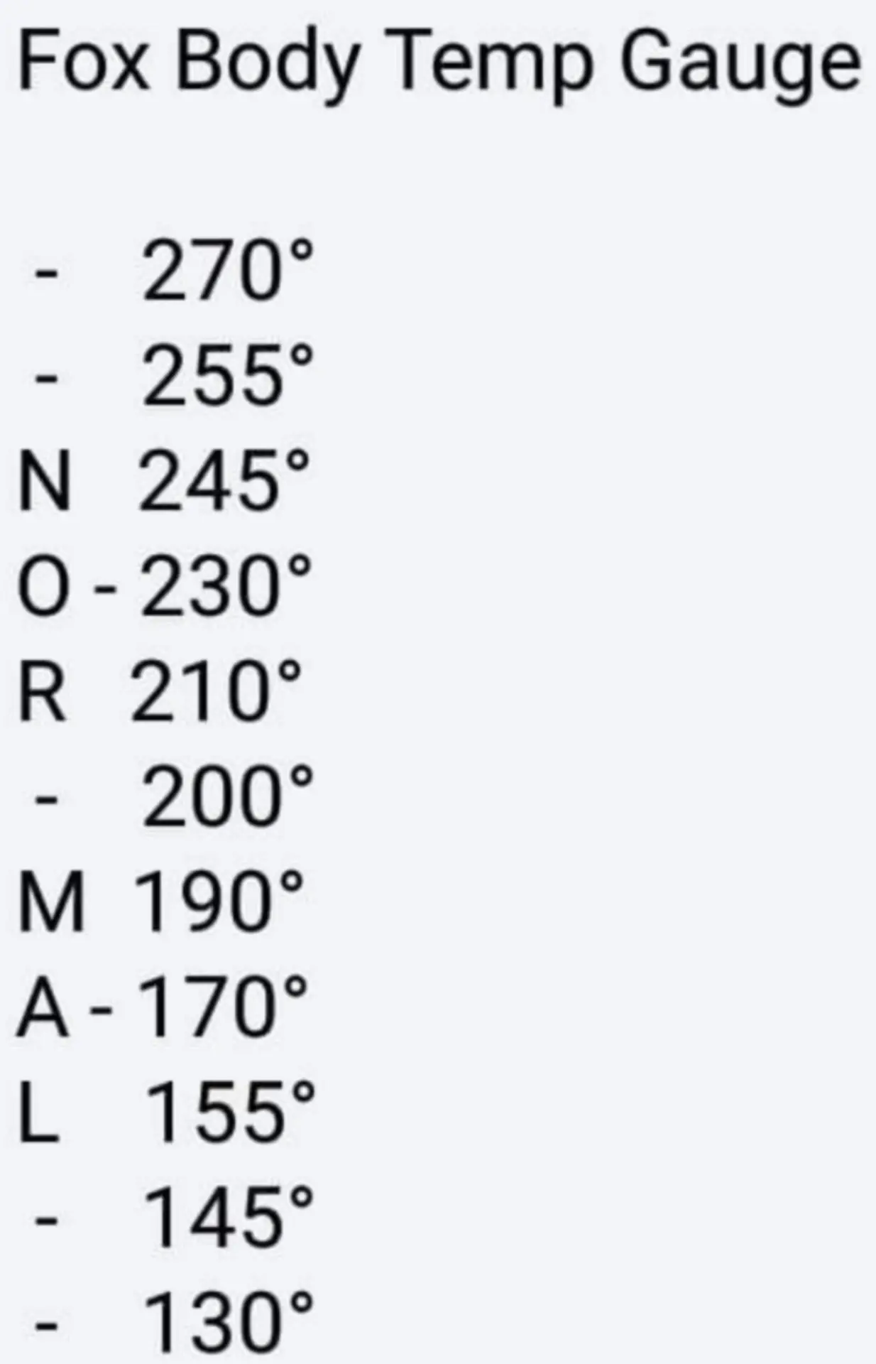

encase you ever wondered

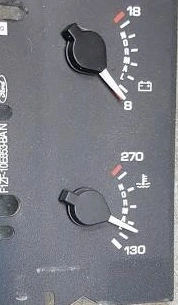

That sort of leads me to believe that the gauge is working correctly as when I was burping the system, the gauge stayed between the "A" and "M" (car is a 93) and I have a 180* thermostat. While driving, it would get up between the "O" and "R". Fan clutch should be here tomorrow, so we'll see if that does the trick. If not I'll put a mechanical gauge on there and see if there is any deviation from the factory gauge. Thanks for all the responses!
