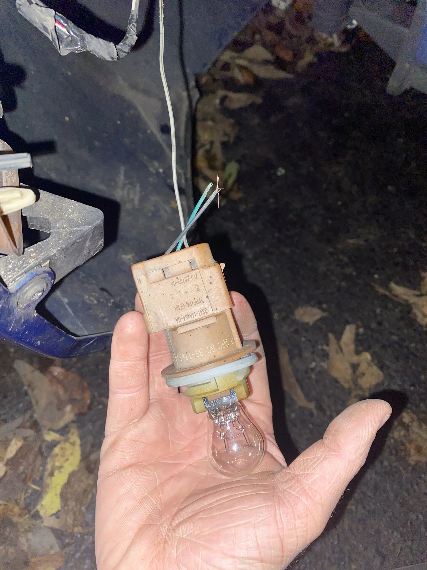

Getting ready to move out of state and this happened tonight, front driver blinker stopped working and went to check and 2 wires were cut.
the green wire is wired up to the aftermarket HALO light, unhooked it to double check.
not sure about the other wire but I’m sure it’s the headlights.
the bulb is good as I pulled the other side to check
should I run the green wire from socket to the original green wire/ halo light so all 3 wires are connected?
And do the same for the black wire?

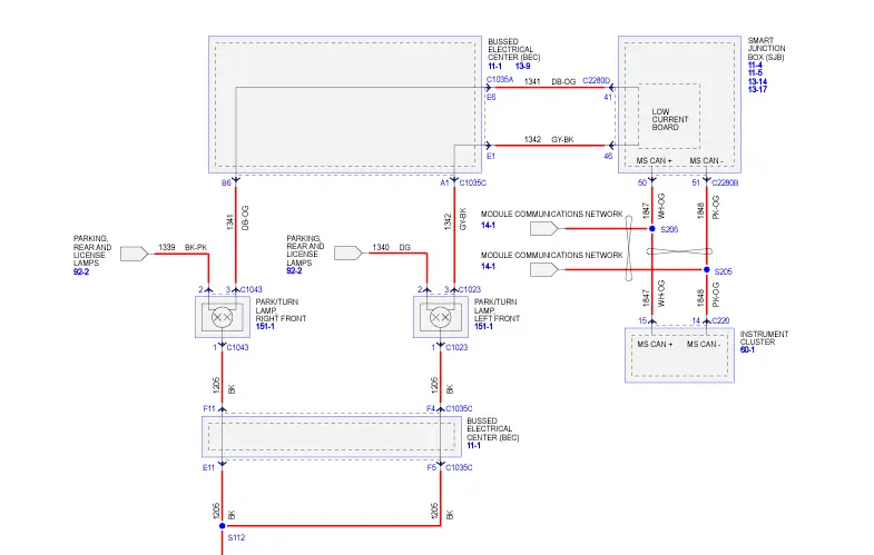

Hi,
Wires appear as if
they were pulled tight until they broke, if a rapid directional occurs, replace the damaged wire(s), system is designed to alert driver of a bad light filament, but a bad connection will also cause this.
Open the BEC, (Bussed electrical center)...reconnect wiring.
The signal begins at the multifunction switch, to the headlight switch, to the SJB (Smart junction box) & to the BEC (behind the passengers headlight) & distributes the signal to the lights.
BEC’s a bit tight access, but easily done, follow diagram below.
Any questions, feel free.
John
