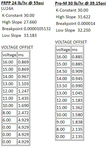

I guess maybe I got confused by your question when you said "will the computer think 19# injectors at 50 psi are the same as 24# injectors at 40 psi". There is also no input in the computer for injector lb #. The computer uses things like voltage offset, high slope and low slope, breakpoint, to set the fuel trims. Different injectors have different ratings at different PSI. When you increase the PSI it just makes the injector act differently than the computer is expecting, it doesn't just think you dropped a bigger injector in there, you're just forcing a rich condition.
I couldn't find 19lb injectors at 50PSI but below is an example of ratings for a 24lb injector at 55PSI vs 30lb injector at 39 PSI. Maybe the difference isn't noticeable to us when driving but the computer knows.
