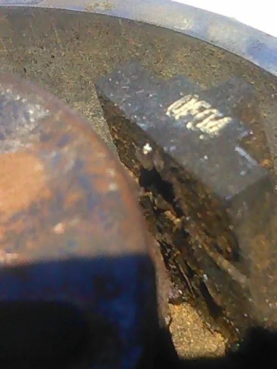

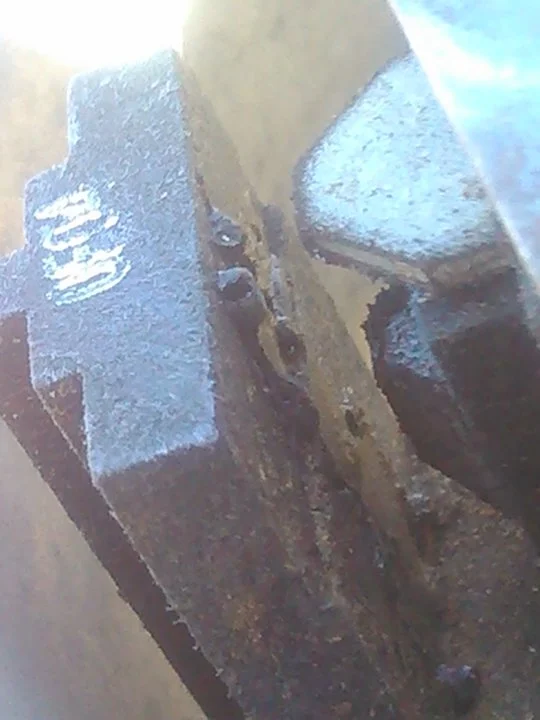

Update: I was messing with the timing and I couldn't quite get it corrected. I removed the cap and inspected the internals and saw that the stator did not quite look right. I disassembled the distributor as much as I could to get a clearer view of the stator, and it looks to me that the contacts are badly burned. I have attached a couple photos of it from each side. It seems to me that this could be a big part of the problem I am having. What do all of you think, should I replace the whole distributor or should I replace the stator assembly?
