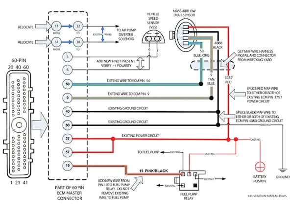

Wire side 60 pin computer wiring harness connector
Computer side 60 pin computer wiring harness connector
If the idea of moving & soldering wires scares you, here's a list of compatible Mass Air wiring harnesses.

Someone did a hack job on the wires and i cant tell whats what
