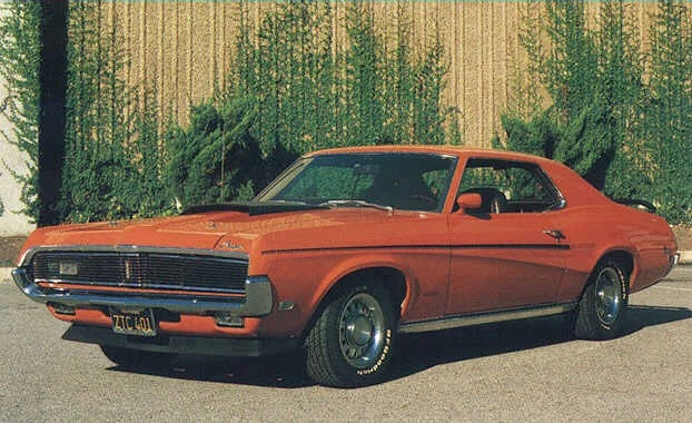

Yes and no. Mercury's hot Cougar was called the Eliminator in '69 & '70 and it was available with the Boss 302 engine. But it wasn't a special "Boss 302 Cougar" per say. They made very few of them.
Here's a 1969 & a 1970 Eliminator. The fast way to distriguish them is the stripe on the side or the grill.
1969 -
1970 -
1969 -
1970 -
Yeah if I remember right, I read on the Boss 302 Cougar website that they only made 169 cars.
