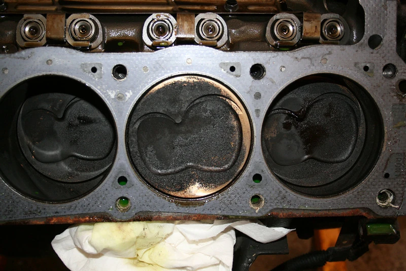

THe pistons aren't stock. it's .030" over and they have a 12cc dish, including valve reliefs cut for the TW heads (I'm assuming as they are not inline).
The pic below is of my shortblock. The dish is pretty substantial and I measured it at roughly 12cc using a syringe.
As far as repairing the heads I have, it would be approximately $600-800. It would make more sense to buy bare heads, and build from there, but I am sick of screwing around with this crap and want to just pull heads from a box and install them on the motor.
I have no chance of making 375 hp with this combo, and I know that. What I have a chance of doing is building a motor that will run on 87 octane, have a lot of low end torque and be fun to drive. just like 5sp gt said, power isn't everything.
