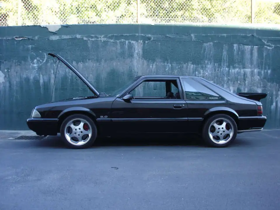

I think the fox bodies look cool lowered , with wheel spacers so the tires stick about 4 inches out of the wheel well. If you install a Ferrari body kit that really sets it off...... Just Kidding. I think I threw up a little just picturing that in my head. The sad thing is , this is exactly the Mustang I have seen

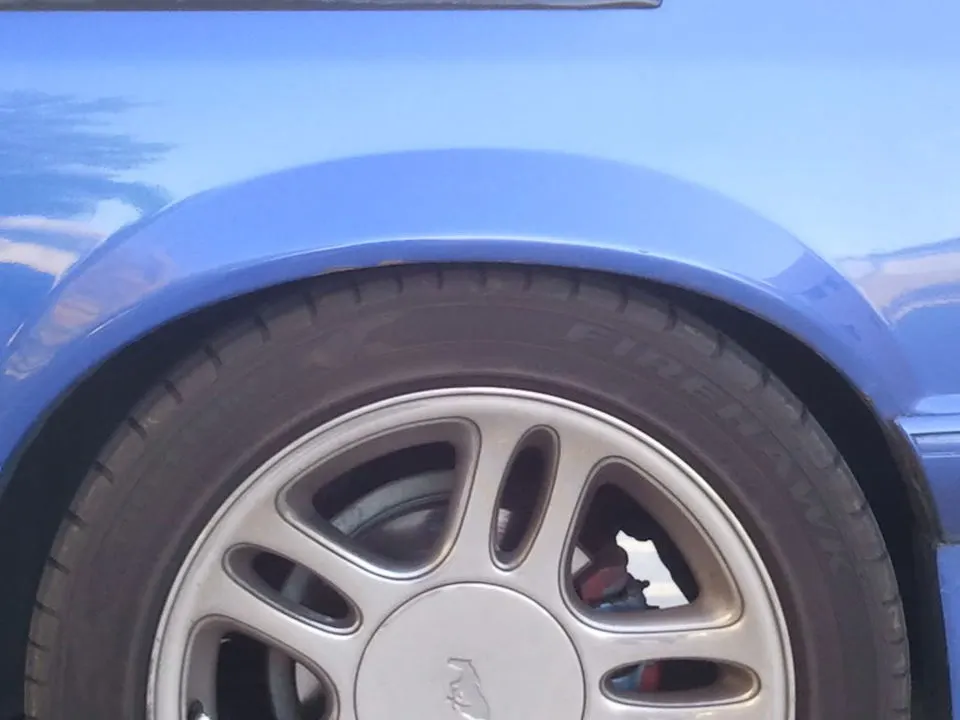

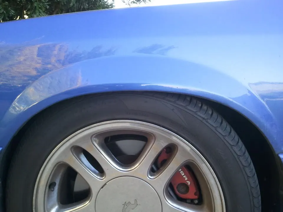

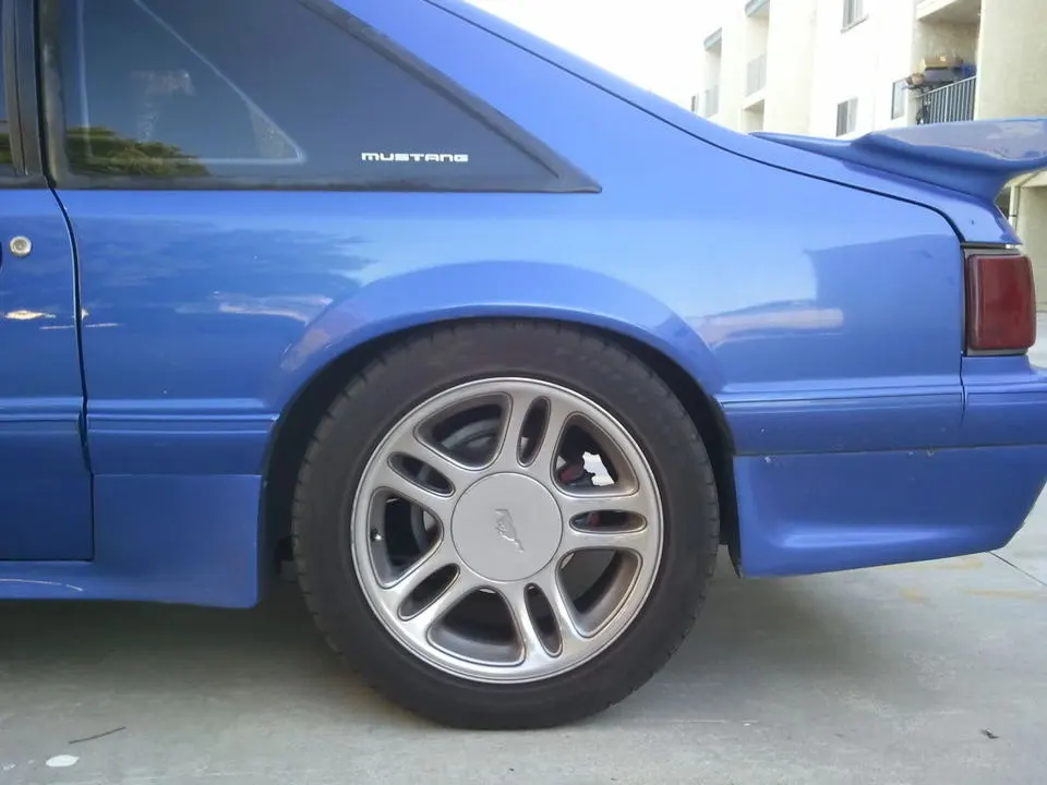

Hay thanks again. here are my tire sizes and pics:
front: Capital Sport UHP 245/45zr17 99w Xl
rear: Firestone Wide Oval p255/45r17 92w
all four tires are 1 yr old. the rims are from a stock 96 mustang.
now the height from the floor to the lip of the fender. all four are different:
front drivers 24"
front pass. 25"
rear drivers 26-1/4"
rear pass. 25-1/4"
i do not know what springs are on there now. i bought it like this. as you can tell the car sits twisted. i don't know if changing the springs will fix this. the shocks are 2yrs old KYB kit from LRS. i want the car lowered just not so low.
