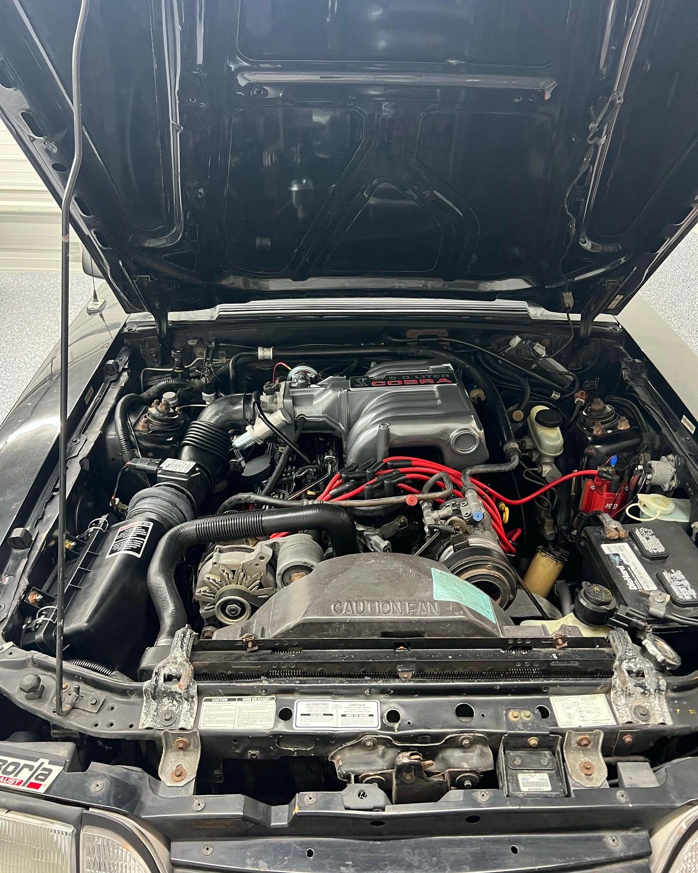

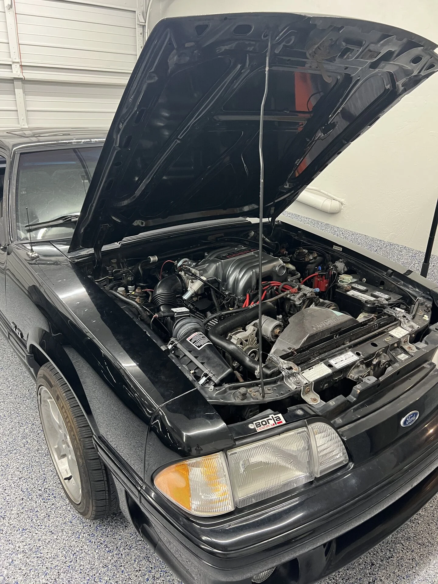

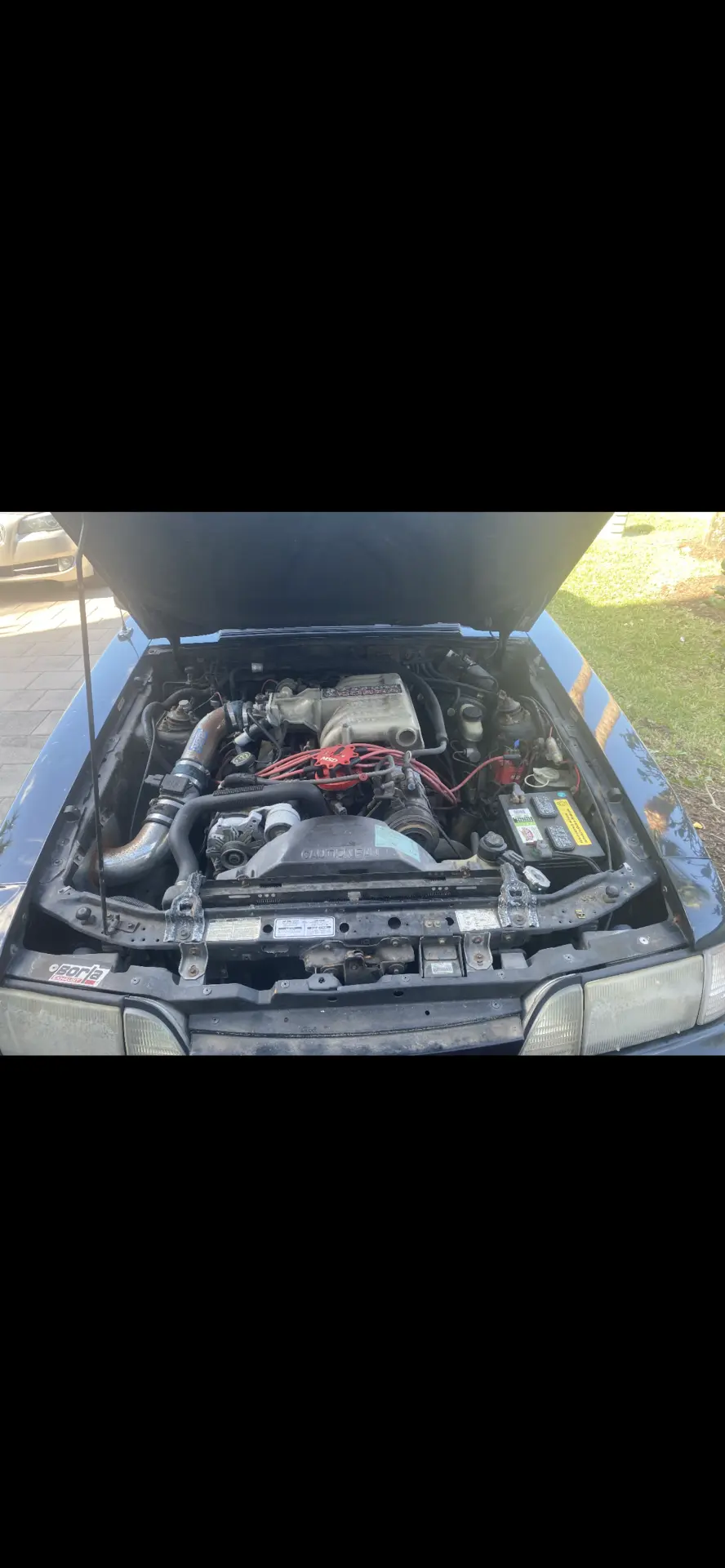

Here’s some pics it’s a 92 gt with 113k miles. The car has a cobra manifold, edelbrock performer heads, x303 cam, and a full exhaust with long tube header, off road h pipe and borla mufflers (will be switching to flowmaster 40s very soon the borlas are too quiet at idle for me). I bought the car 3 months ago and it had been sitting in the previous owners driveway for 5 years and didn’t start. When I got the car did a full tune up and a new starter and she fired right up. I’ve pretty much freshened up the whole engine bay as you can see in the pics. Along with that I’ve also changed out the whole fuel system as well after the old rusty tank clogged everything. Also will be installing new Bilstein shocks and H&R springs this week. Also as you guys know the oil pan gasket and rear main seal is leaking so I’m having the shop take care of that as well as the other things I mentioned before in this thread. She’s definitely going to need a paint job the hood and roof is cooked and since it was a New York car it does have some rust but nothing too bad the only major structural rust is on the door jam so eventually I’m going to have someone cut that out and weld in some new metal. Here’s some pictures of when I got it and now.

Looks good. How does the air conditioning work
It doesn’t unfortunately haha. The compressor works it just has a Freon leak. I filled it one day and heard hissing from around the accumulator later on. After that it stopped blowing cold. Next time I go into the auto parts store I’m gonna pick up some Freon with uv dye so I can verify where the leak is. No ac in Florida right now sucks!

Love that the stock air box is back in there. I would 100% change the oil pump and oil pump shaft as the shaft is an item that will eventually fail, probably when you have the motor spun to 6k rpms. Ram clutches have a good reputation so I would go with your installers recommendation. Get the energy suspension mounts, and stick with a rubber trans mount, that will keep some of the NVH down.
