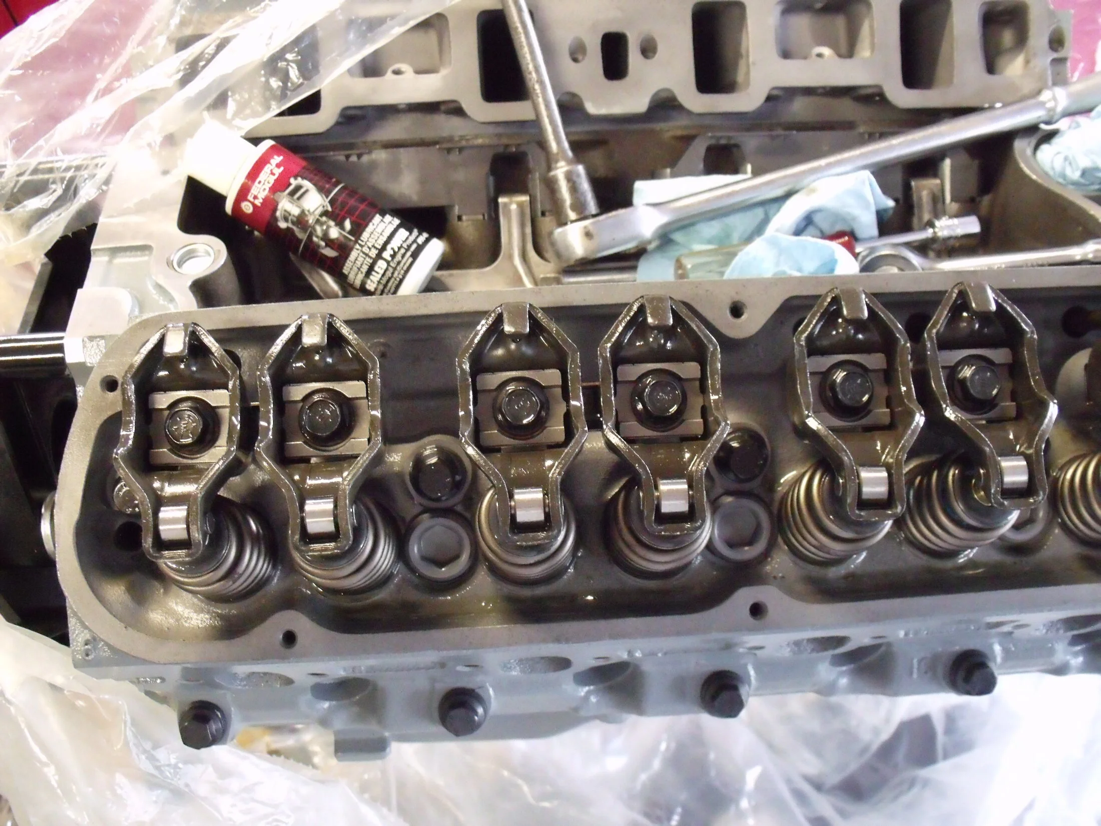

So stock heads have pedestal mount and aftermarket heads can have pedestal, stud, or shaft mount but I would say stud is the most common. Differences can be seen here:
If you are keeping the stock heads then pedestal mount is what you have and the stock ones work really well. I would not go with a B cam as the exhaust ports are severely restrictive on stock heads. You need a cam the will have a little overlap to help with scavenging. I’m no expert but I’m pretty sure that would be the way to go. Couple of knowledgeable guys are already on this thread that can help you out.
