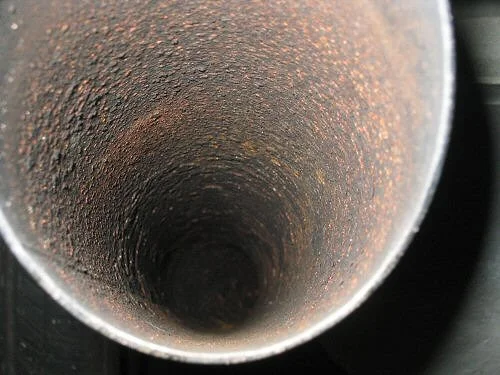

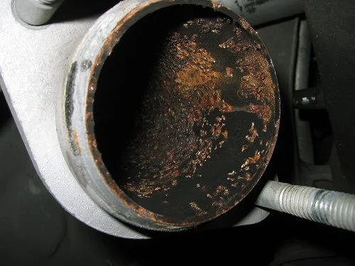

I've had my MAC bolt-on kit for a while now and this rust problem is getting pretty bad. I called MAC and they refused to replace them stating that it's not covered under warranty. I filed a report with the Better Business Bureau, but they still refuse to replace them. Their latest response is that it's my engine that has caused the rust. My brother has the same kit and the same problem. And I know others have also.
So, what I really need is some others with the same problem to contact the BBB. MAC have finally decided to go to stainless, but those of us with the chrome kits will be left with an exhaust that'll continue to rust.
So, if you have a MAC exhaust and are having problems with rust on the inside of the pipes, please go to http://www.labbb.org/scripts/cgiip....fault.htm?hCompID=13027041&hAKAID=1&hAddrID=1 and file a report with the BBB.

Dude, i just checked out the pictures. Are the outside of the tips rusting or just the inside?
If it is just the inside you are too damn picky. If it is the outside chrome, well there is a warranty for three years if I am not mistaken and you should clean and polish them regularly to prevent them from rusting on the OUTSIDE>
yeah, its apparent from the pic there fine, see the exposed bolt from where they hook up to the old pipes? no rust on the bolt! that means there going to hold up unless you plan on driving your car in the salty ocean or soemthing? if it make syou happy get new stainless tips for the damn thing?
Last time I checked, no one could see that freakin far up the exhaust tubing anyways. The only way to find that out is to sit under the car and unbolt the tubes, loosen the other bolts after that part since it probably won't move if you don't, and to pull them apart. If someone wants to do that just to see if there's rust, be my guest, Mr. Picky of Nit.
naw, its not like that, lol, there is rust throughout, but only on the thinnest of thin layers on the inside of the piping, not nearly enough to compromise the structural rigidity of the product, why do you think people like me and many other have them and swear by them? Just be happy they look awesome from the sides
Any number of reasons can lead to pipes rusting from the inside out. After 10K miles, I'd say yours are holding up very well. Like was mentioned, you have to clean and polish them every time they get dirty or it rains. That is the nature of aluminized steel. MAC even states that much when you purchase them. You have to know the product you are buying. Something like this is the reason to get aluminized steel headers HTS or ceramic coated.
If you make many 15 minute or less trips in the car, the pipes will rust out from inside due to the condensation in the pipes, and the car's inability to dry it out in just 15 minutes. Weather changes also affect pipes as well. A cold night leading into a hot day will force water to form on the inside. In this case, you gotta blow out and dry the systyem by running the car. There's no way around it. Just plain humidity will cause this condition as well.
These types of things happen on all cars, and all types of exhaust. I rotted out a stock stainless steel muffler once in under four years because of this. Not covered.
I understand your frustrations with the kit, but complaining to the BBB won't turn up any results just due to the fact that there is a disclaimer on the product. I drove with my MAC's on in the Buffalo winter, and that alone constitutes neglect according to MAC. The aluminized steel is what it is, and there's no way around it unless you get the whole system coated in ceramic before you put it on.
I would just use Mother's Chrome Polish on the tips to keep them looking good and to remove rust. It will take some time, but it is worth it. Next time, you may want to consider stainless steel, as that is the best there is out there.
Sorry for your troubles, though.
I know it's not that bad, but I don't really like paying $300 only to have it start to rust after a couple of hundred miles. The stock exhaust made it through more than 75,000 without a spot of rust anywhere (inside or out).
ugh i wrote a post back to this a day or two ago....this is annoying. you are getting nothing more than surface rust, which is to be expected. unless you are getting a rust through problem then there is no reason for MAC To replace that stuff...its perfectly fine.
