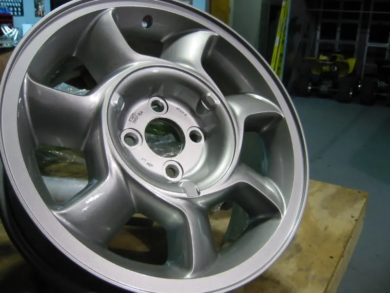

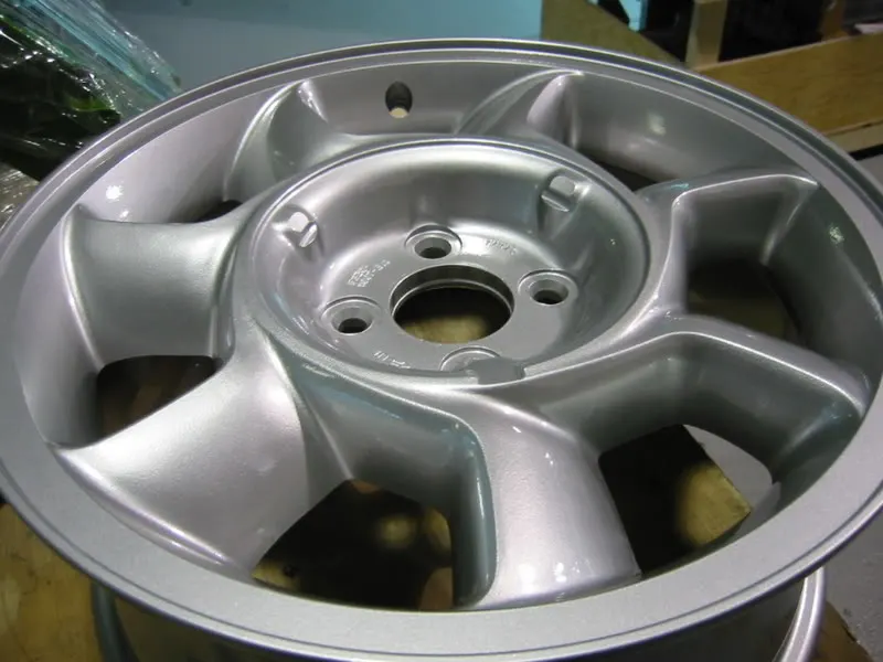

Sorry tuned there is no way I would ever even consider getting rid of those wheels. They are in mediocre shape right now since the previous owner let a rear caliper explode flaming hot brake dust all over them and apparently let it sink in for a couple of days. I have tried everything I know of to clean them and taken them to a few different detailers and it will just not come off. I believe they will have to be refinished, I just haven't found a shop in Columbus Ohio to do it yet. I did manage to get a lot of the mess of of them and from 7 feet+ that wheel looks just fine, the rest of them still look really good with only slight signs of fading.
I do have an odd situation here though with wheels; hear me out. I would like to get my Cobra wheels refinished and just bolt them on every now and then in order to keep them in good shape. Problem is I have no idea where to find wheels that will fit this car :shrug: The Cobra has a different wheel offset than the other 4 lug Mustangs and I believe all the aftermarket 4 lug wheels cater to them.

As for Cobra wheels, I got mine powdercoated by http://www.northeastcoatings.net/. Ask for Al - he did a great job on mine.
You are correct, the offset of the factory wheels does make it rather challenging to find a wheel that will work. I don't know of any that work on the stock 4 lug cobra rotors other than the original ones. If you want to run the replica Cobra rims or other 4 lugs then all you have to do is put the GT rotors on the front of your Cobra. The rear axles will be fine as long as you stay under a 275 tire in the rear.
ok just so I have this right, can I use up to a 275 or does it have to be less than 275? 275 just so happens to be the width I want to run.
And wow, they did a very nice job on those wheels. How much did that run you and how much did it run to ship them your wheels?
