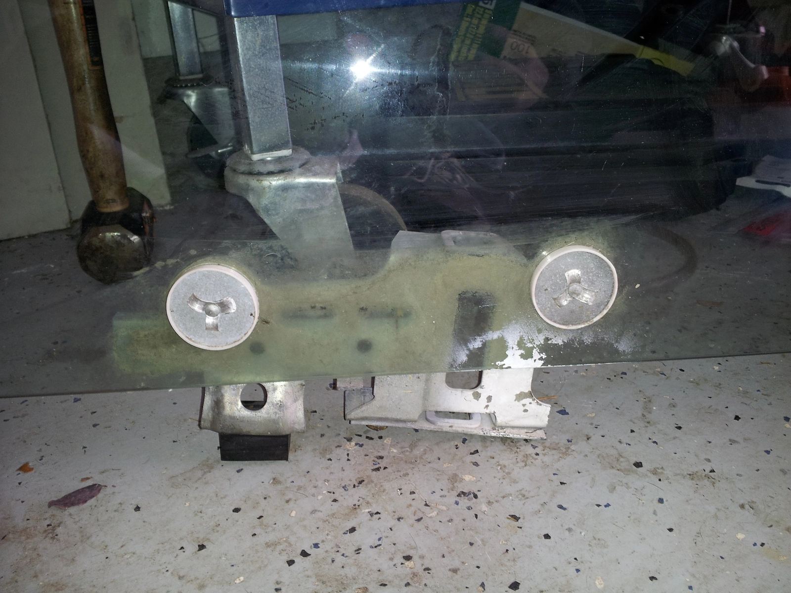

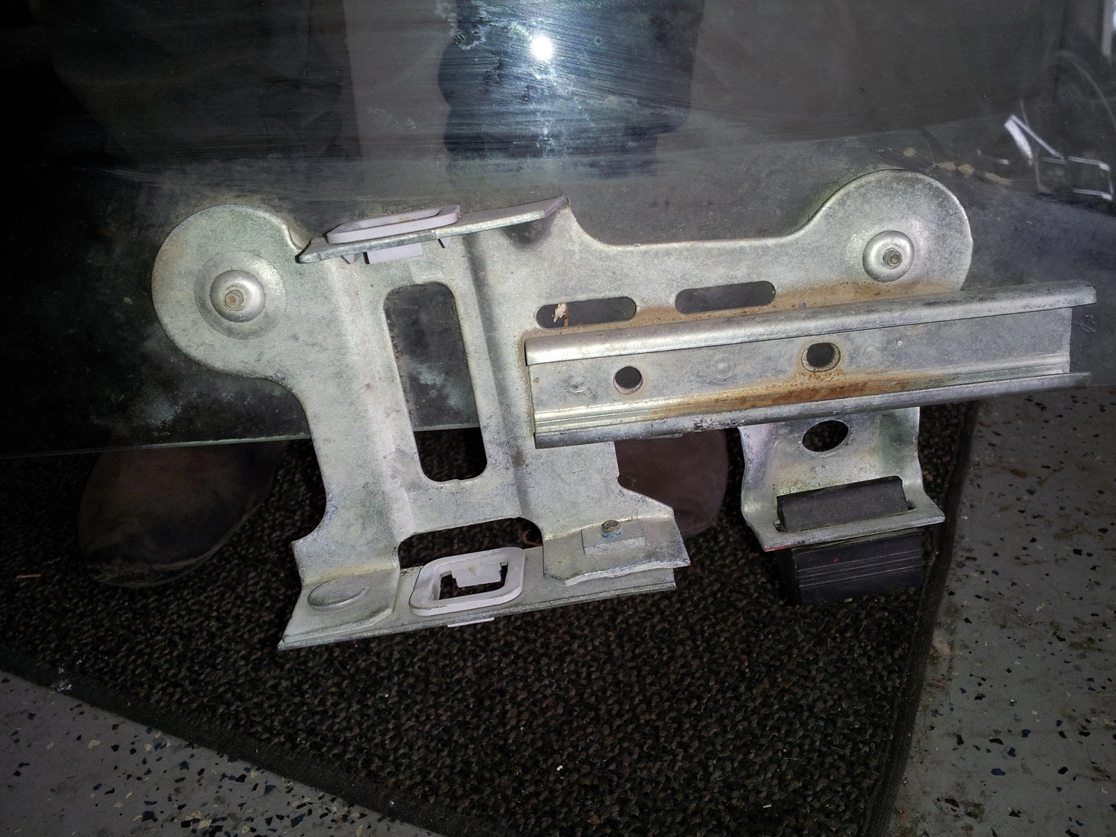

Yep, you need to remove the rivets in the middle of the plastic bushings on the glass - you can drill them out. You then can replace those rivets with a bolt and nut when you reinstall it to the regulator in the door. You can size the bolts by popping off the plastic bushings and taking them to the hardware store. Go as short as you can while still having good thread engagement. I used an allen style bolt because I thought it would be easier to maneuver the allen inside the door.
or should i maybe take a dremel and cut those three prongs off? and then put a center punch on the center of the rivent on the side where its domed as shown from window 2 pic and hammer from that side? or do i not need to cut those prongs off?
You can do it that way, but when you drill it out you knock them off anyway. I just like to knock out the center (from the side in picture 2) because it makes it easier to drill. You can cut the prongs off the back, it just takes longer that way IMO, but if you feel more comfortable with that then that is fine. Basically, do whatever you need to get that piece separated from the glass.

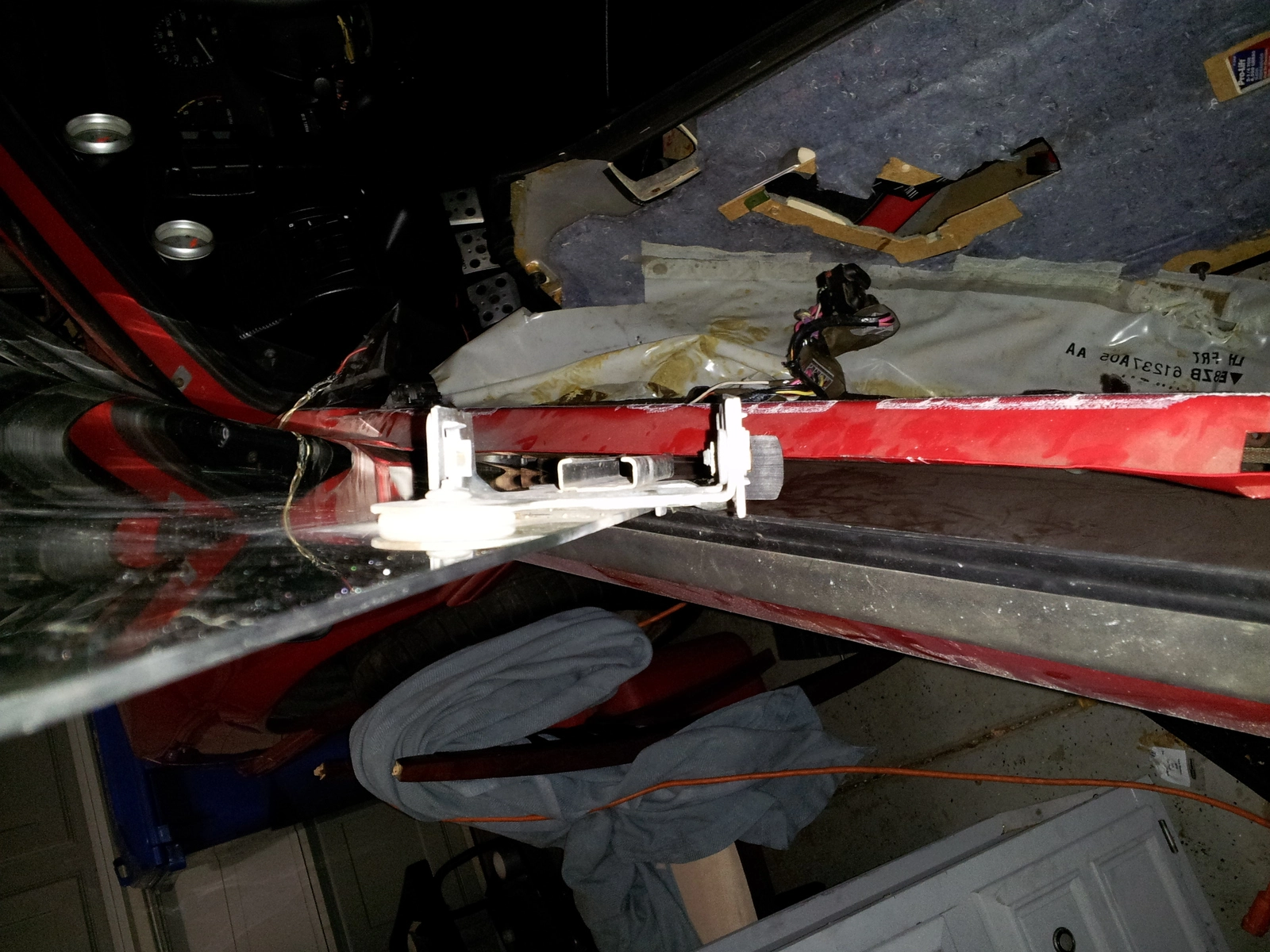

well i got the rivots out. the window.holder in the door. window in door and everything bolted up. however when you first hit the down button it pivots towards the front of the car then goes down. likewise when you first hit the up button, it pivots towards the rear of the car before going up, then goes up... it misses the track where the window eedges into the door toward the rear of the door then correscts itself.
does that lil square that runs in the track of window have two different widths? maybe thats why its rotating... any other ideas? also how much do you tighten these bolts down?
