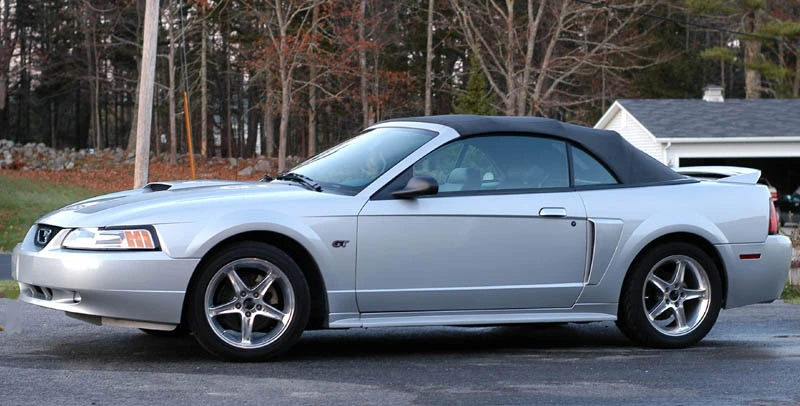

Here is my 2000 GT Vert with the Pro Kit.
the lower front looks better to me. It's not like the rear is jacked up. It is not drastic, just gets rid of the gaps in the fenderwells. I installed FRPP. If you want it to look a little lower but it not be lower, spend the $ 70 on a mach 1 chin spoiler.
Dude was that Pic Before you put the spings in.
