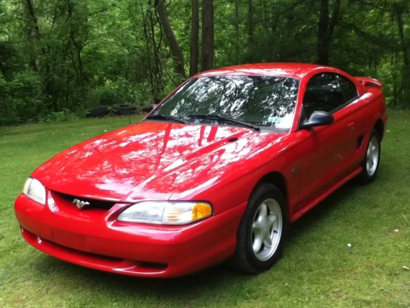

Hey everyone, names chad. I'm 21 and own a 96 gt. Bought it last summer, it was a 1 owner with 36k miles on it and now has 48k. Its completely stock but I'm in a predicament. I want more power(of course) but I'm trying to decide if its better to keep this 96 and build it up or start with a new platform that will respond to upgrades better? I know the 2valve is really weak but since the car is basically new its hard to get rid of it and end up getting a newer model with more miles...My goal is simple for now, nothing crazy, I'd like to come as close to 300hp as possible without adding any forced induction for right now. I know ultimately its my choice of what I should do but I'm just looking for some opinions on what you guys/gals would do? I can have engine work done for free by my uncle so thats a plus, but it just seems like it takes so much money to get one of these 2 valves up to my hp goal
That's a sweet looking Stang man! I wouldn't say the 2v is weak, it just takes a different approach to get the hp you want compared to Chevy motors... There are guys that have put turbos, and superchargers on their 2v's that are making some impressive numbers. Also some have done full bolt ons with H/C and have got some good power out of a 4.6. I have read though that if you want to stay n/a the price is a little more.
