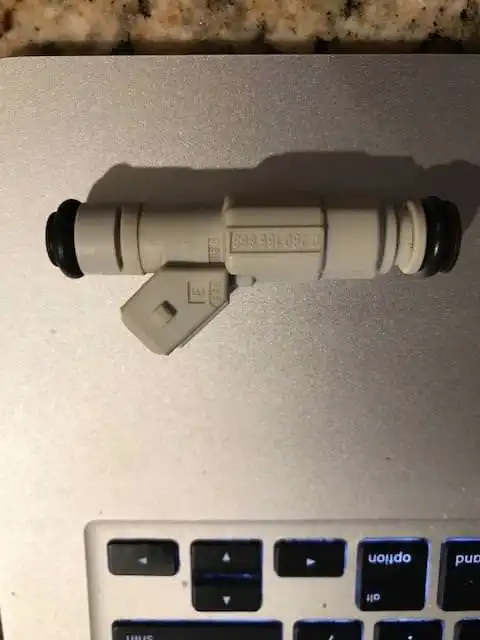

I purchased a set of 36# injectors used. I would like to get them professionally look over. this is for a 2.1 KB build. any suggestions to contact?
thanks

will these BOSCH 0280155868 fit my 2001 with Kenne Bell?
