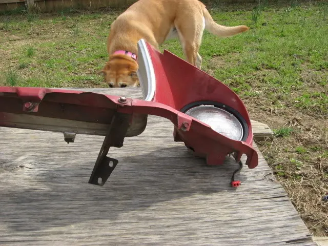

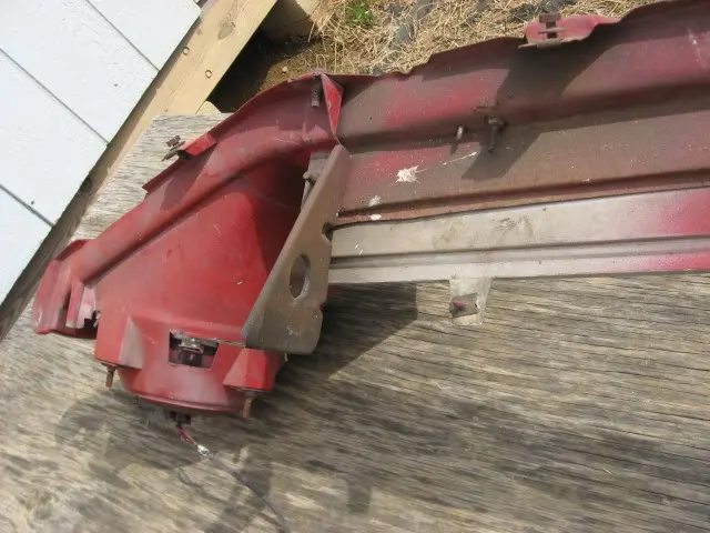

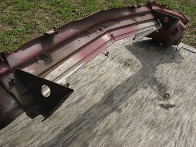

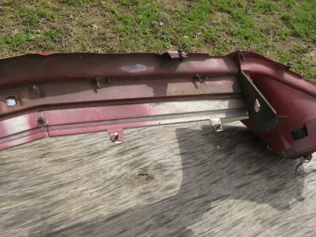

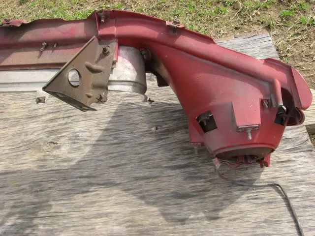

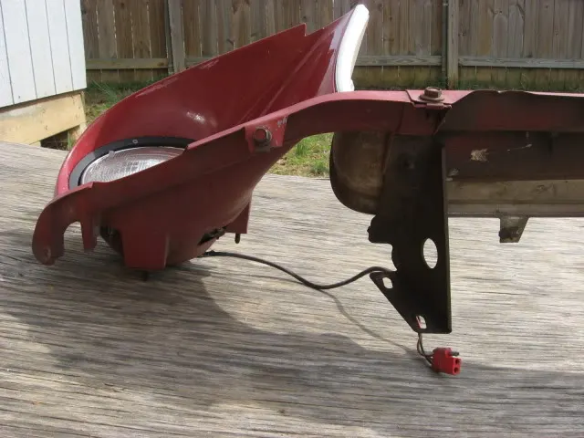

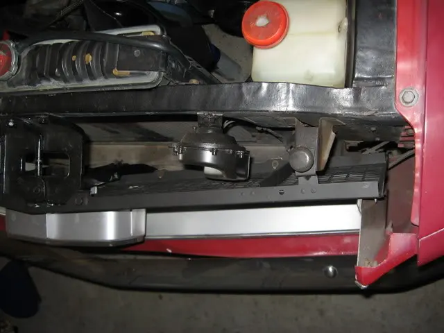

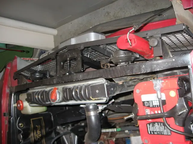

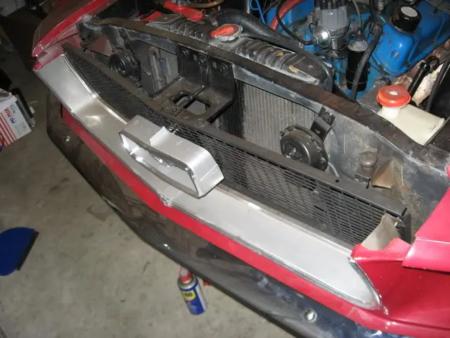

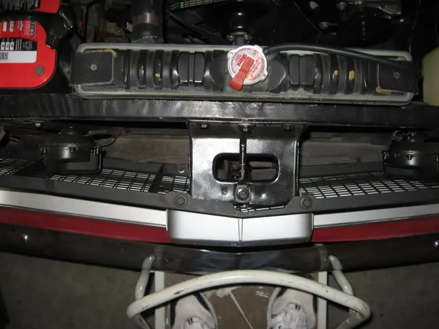

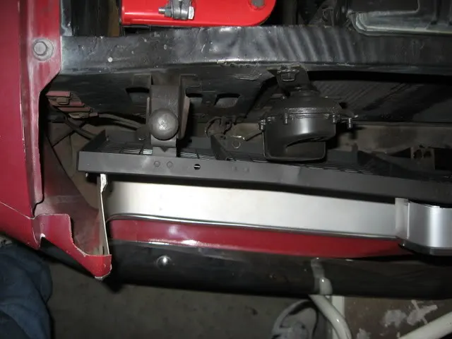

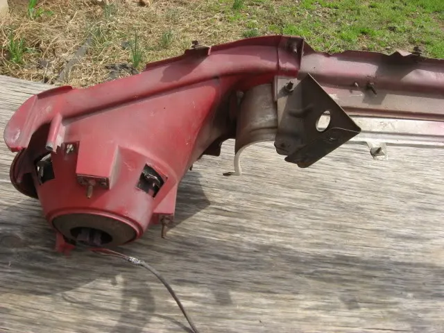

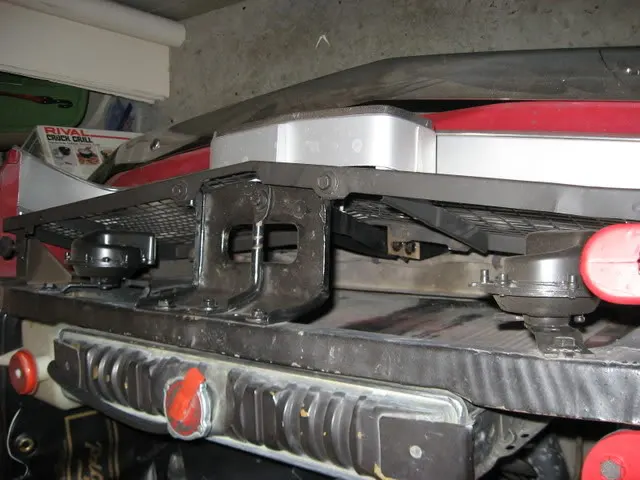

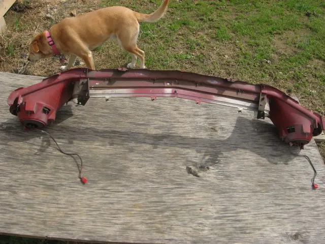

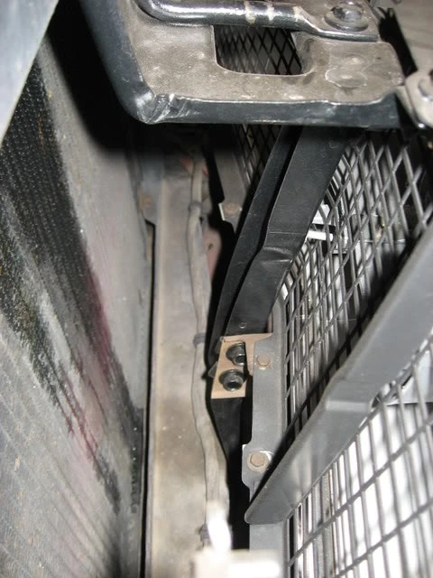

I'm the guy that's putting a 68 tailight and 68 front end on a 89 mustang.
Since I have nothing to work with, I am using replacement parts where possible, but I'm having to hand fabricate alot of stuff. I was wondering if any of you guys have some pictures of what the supporting structure looks like behind (and under) the grille.
Thanks,
Mike
Here's the only ones I have of my '67 before teardown:
Jon

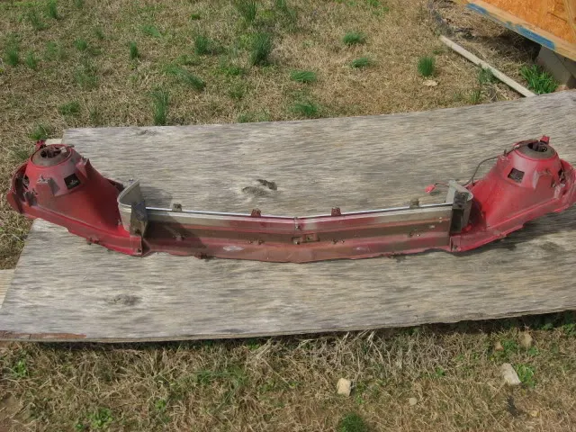

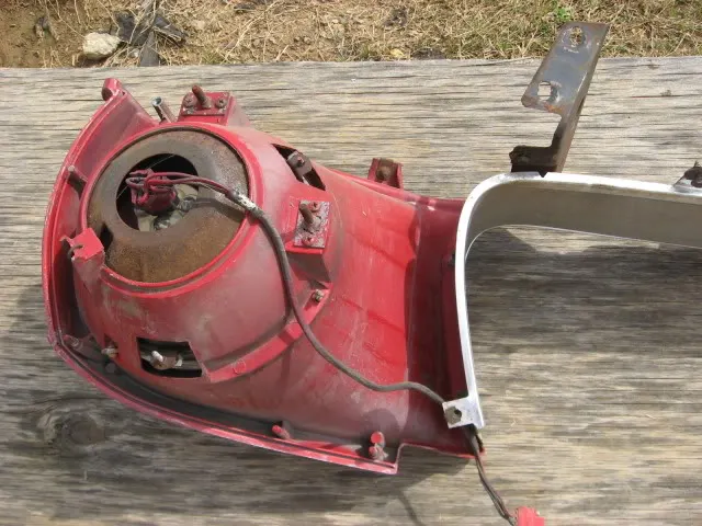

It's all off the car now and hanging in my shed. The silver surround is still attached to the lip under it and the headlight buckets. If you can PM me this weekend I should be able to pull it out, flip it over and take some pics. I'll forget otherwise.
Jon
