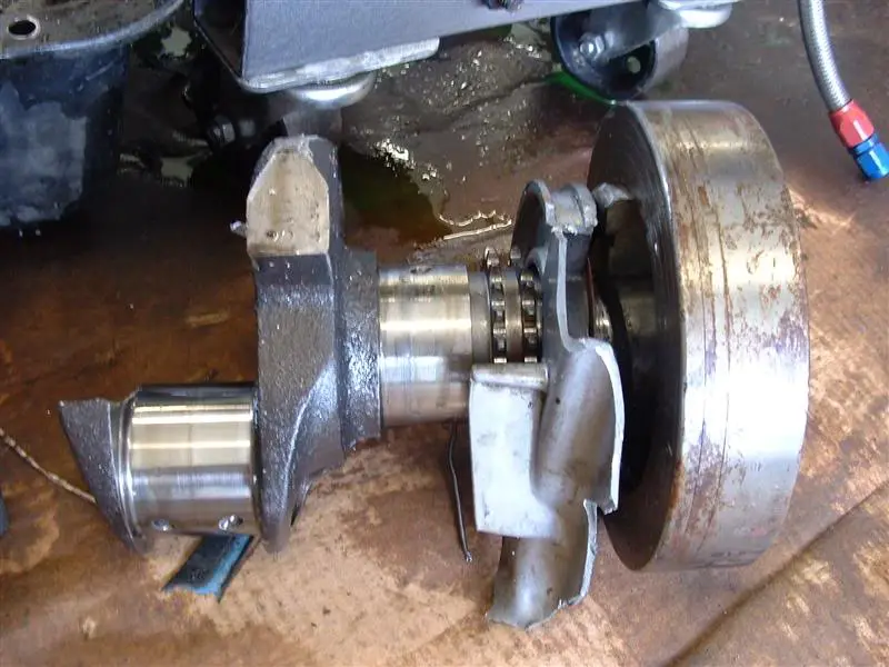

The only issue with a CAST crank in a blower car is SNOUT strength, there is an extreme amount of stree put on the snout and a cast crank just is not made for that, that is why I try to push most blower customers to a forged set-up if at all possible.

The snout is stressed due to the blower pulley being so far out off the end of the snout. Belt tension also has a huge impact..
I have run cast crank blower motors for customers, you just have to be aware of the things I mentioned above, and tune conservativly.

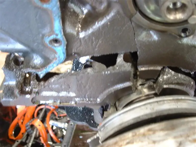

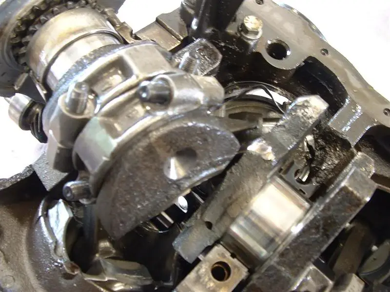

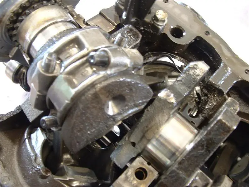

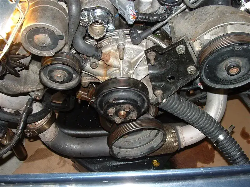

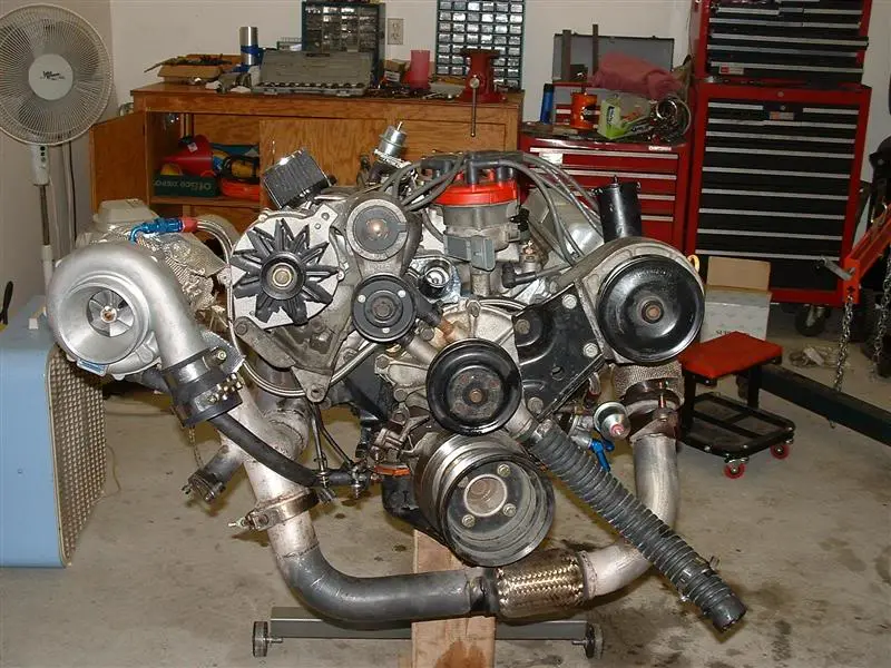

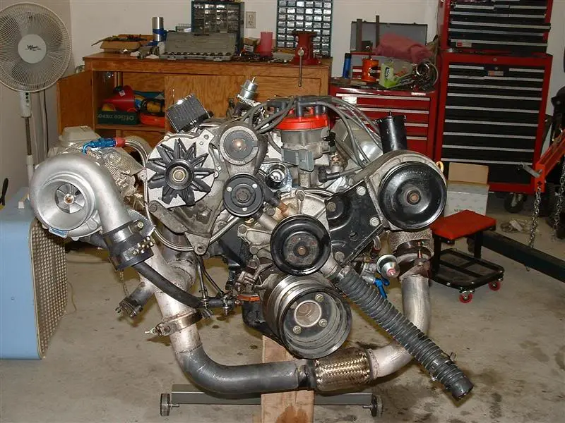

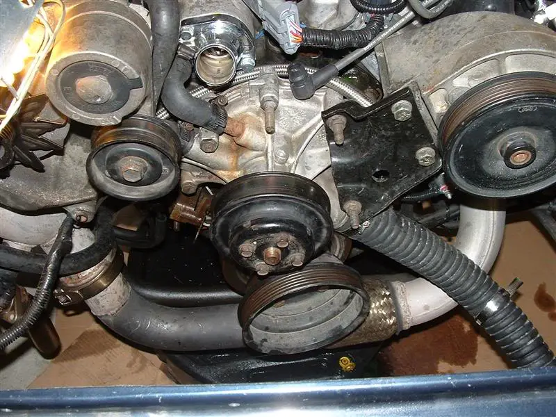

OMFG! That hurts just to look at it. Sorry! I can only imagine what it felt like when you heard it happen and when you finally looked under the hood to see that!:notnice: :bang:
lol

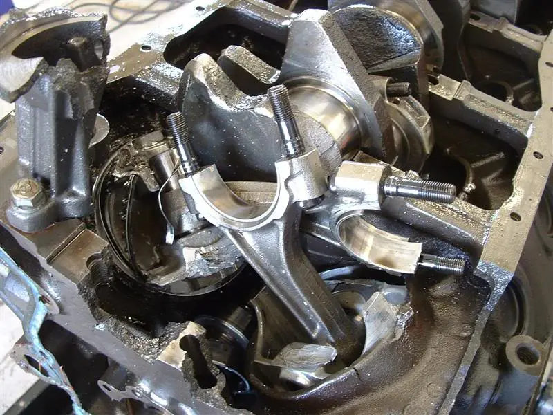

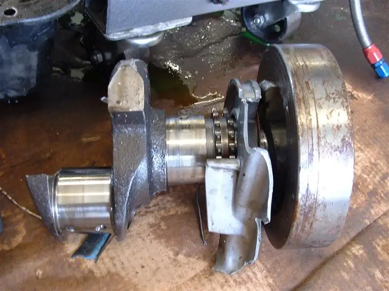

Yeah man i was pretty much ready to cry... got it inspected the day b4... was runnen great! went to work that day to show everyone... All i did was put it in neutral and was ready to turn the key off and that happend... Hard to beleive it went down at 900rpm eh? I still can't really beleive it lived for 15 miles of highway and back roads all the way to work and died in a parking space.... However the good this is the heads were in perfect condition! It did however shear the oil pump off, broke the waterpump in half, and bent my distributor and oil pump shaft... Def more then i had thought woulda been destroyed....
The motor was just a stock block, cast iron crank and forged pistons.... Like i said b4 it's had 500RWHP with a supercharger all it's life, and then a turbo at the end.. however i think the damage was done by the time i put the turbo on... I was getting vibrations etc at certain RPMs.... So i think it was on it's way.... My engine builder came back with a cost of about $1600 for the balanced and assembled short block... The new combo is goin to be
