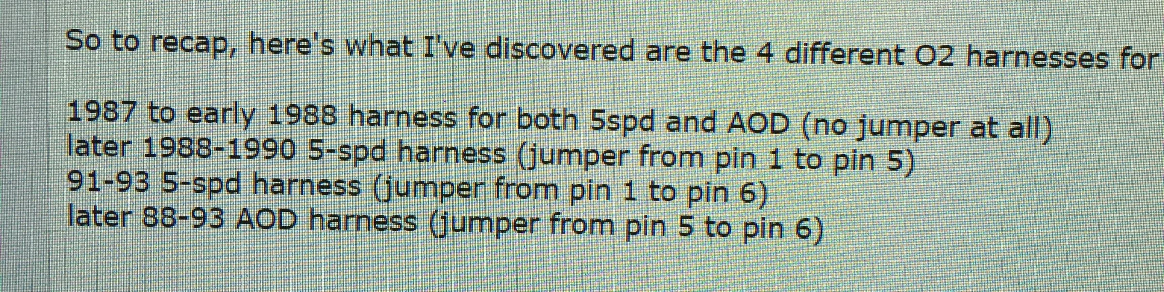

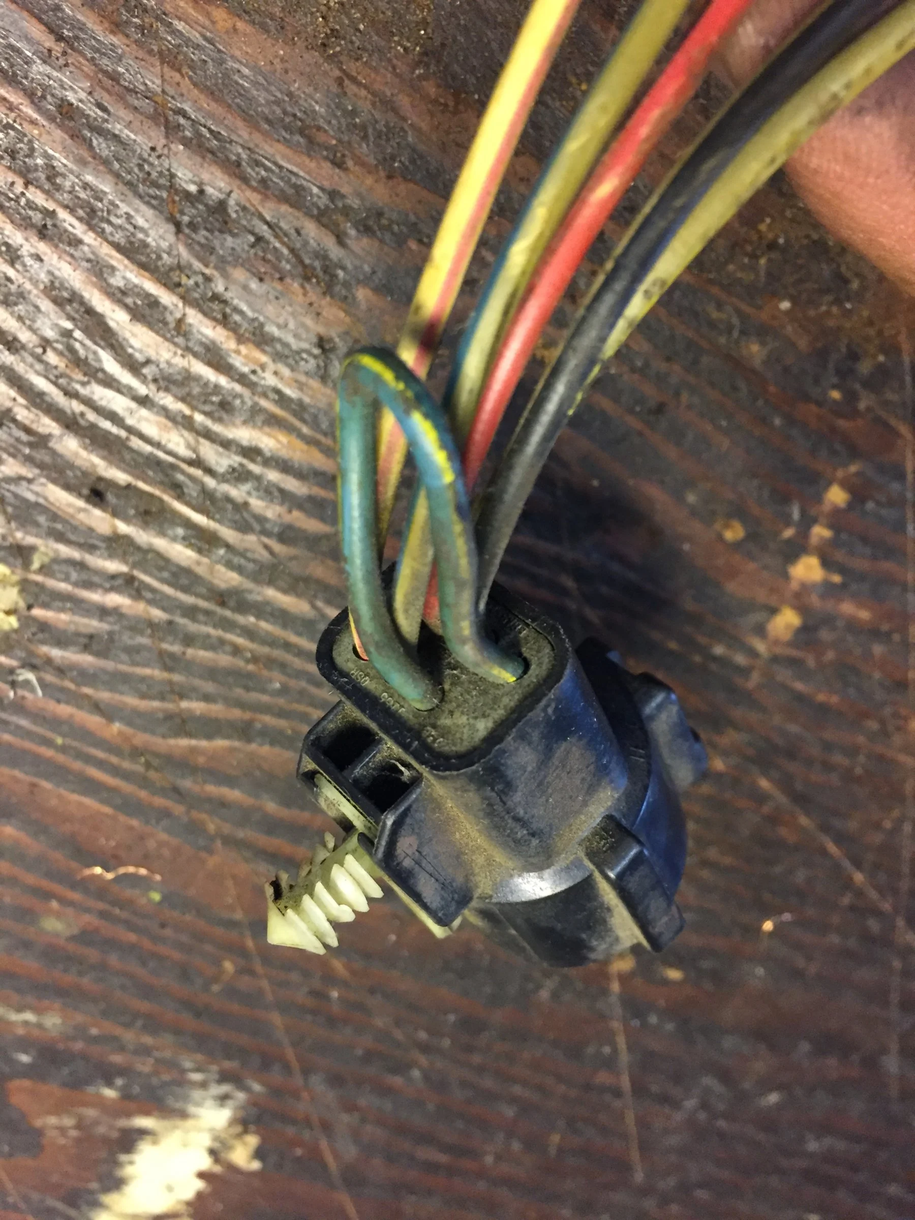

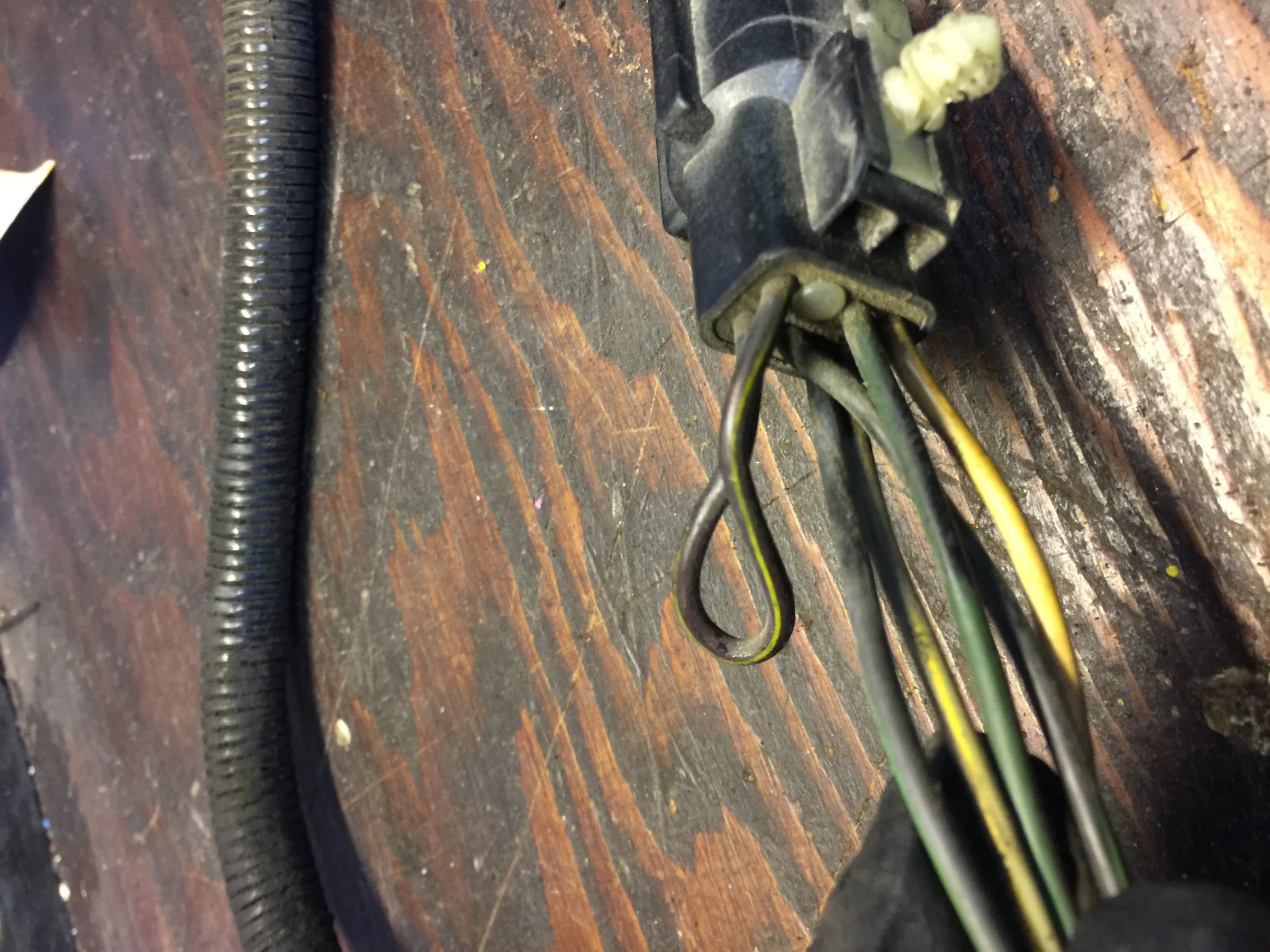

so the pin locations on my o2 harness should be 1 and 6 for a 92 with a manual? if you look at my post on page 2 with a pic of my o2 harness, it looks to be in the correct position, 1 and 6. I will need to check when I get home for confirmation because im not sure if that's a pic of my old harness
