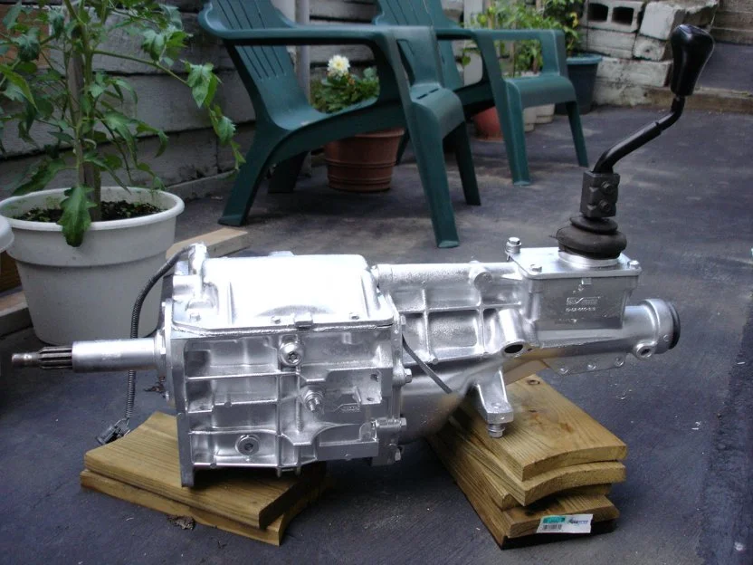

Here's a 1985 T5 I had that shows the switch on the passenger side. This is a non-WC t-5.

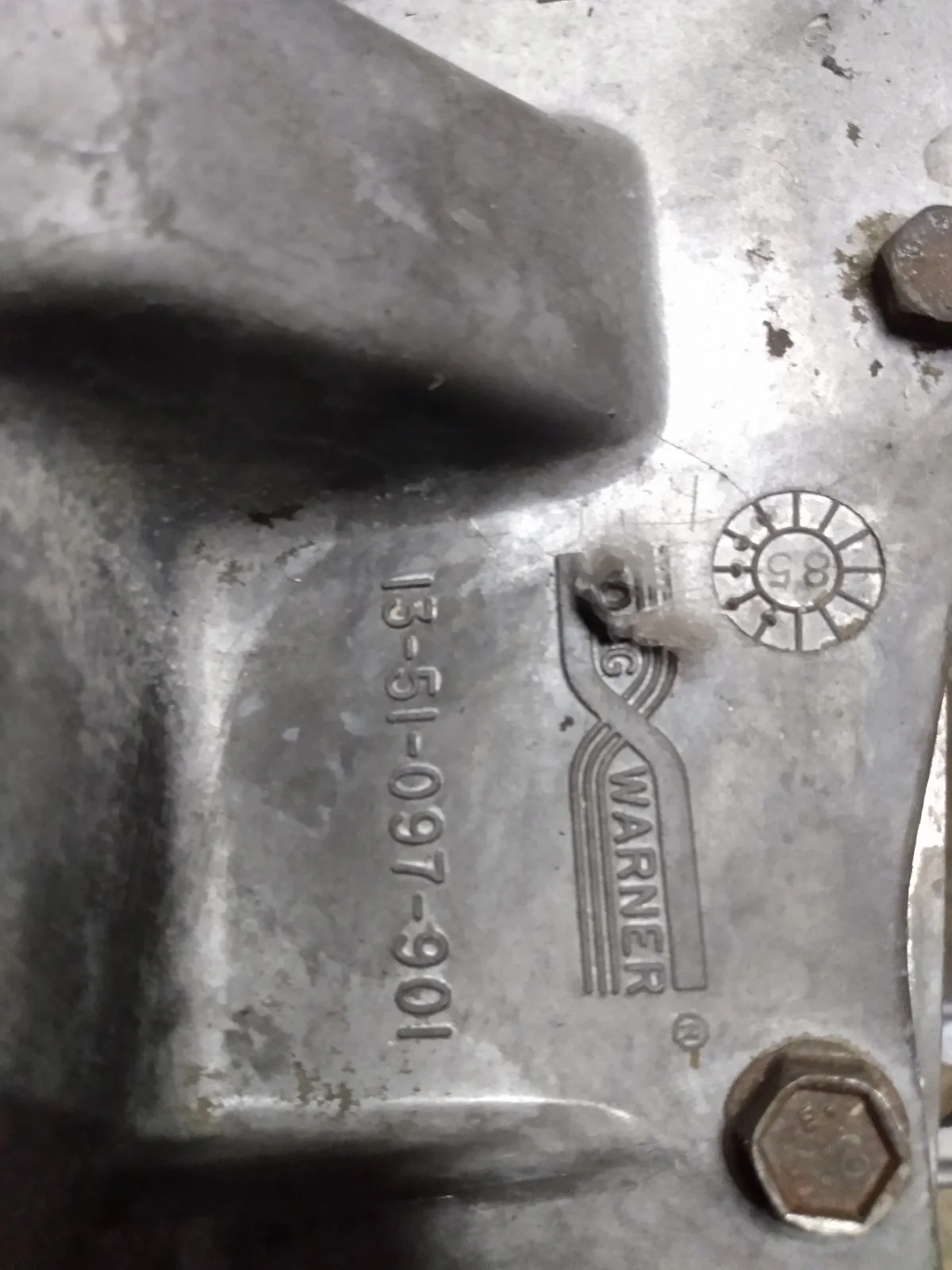

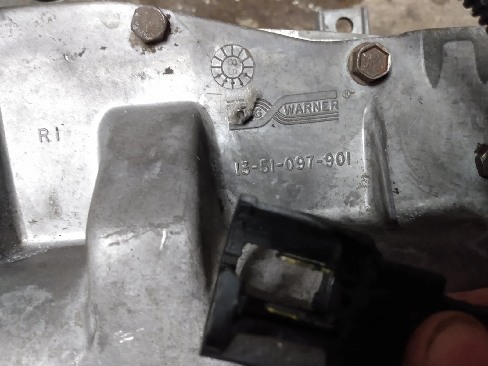

Here is the pic of top cover and plug
# is 13-51-097-901

here is a cut and past from Astro t5 ID page for 13-51-097-901 and you can see the plug has 2 blades and the large connector, My 86 AOD harness has same connector but 4 blades. FYI - I have both t5 trans harness (with smaller pin connector) and t5 02 harness on hand as well as the stock Auto harnesses.
Top Cover CASTING NUMBERS:
13-52-097-901 Early style plain top - Ford & GM (no neutral switch)
13-51-097-901 85 Ford w/neutral switch on RIGHT SIDE

The AOD neutral switch is completely different. This is the one that won't let the car start unless the trans is in neutral. It's 4 pin, and 2 pins are the reverse lights. When you swap to a T5, the small plug has a jumper in it. This jumper is for the AOD neutral start switch.
Mustang Manual Transmission Reverse Light Harness (87-93) FH-055
Use this direct replacement 5.0 Resto reverse light harness to fix a ripped, torn, or malfunctioning harness!
lmr.com
You can see the red jumper in the harness. This jumps out the NSS for the AOD.
The plug on top of the T5 is actually called the NGS. It plugs into a different plug that isn't present on the AOD transmission harness. The trans harness runs from the driver's kick panel, out the trans hump and to the transmission. On the AOD it only has two plugs. One for the VSS and one for the neutral start/reverse lights that plugs directly to the AOD. On the T5 harness, there is a 3rd plug...the NGS plug that connects to the top plug on the T5.
So if you are doing a 5-spd swap on an AOD car, you need to change out this entire harness to get the proper plug. OR, you can cut the connector off, solder or crimp on 2 longer wires, and run them over to the driver's kick panel and tap into the proper wiring in the panel. Same thing.
Also, 1986 O2 harness does not have the jumper for the starter circuit running through it. It's wired differently and doesn't go through the 2 harness. No need to change anything here. The repining of the O2 harness starts for mid-1988 and up cars.
