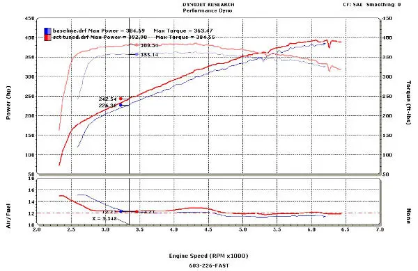

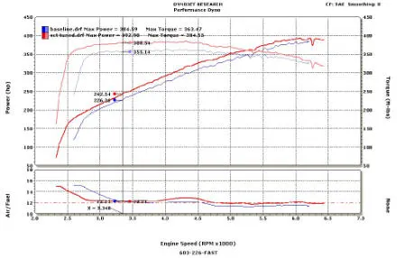

I bought a Screaming Yellow one on Thurs. As I own a Dyno-jet dyno and am an SCT dealer we dumped the oil, baselined it on the dyno and already burned a chip. The car baselined at an SAE corrected 385hp/361lb-ft and after the SCT tune we got it to 392hp/385 lb-ft. The motor gained 16hp and 30 lb-ft from 2000-5500 rpm. Hard to believe it's rated at 390hp at the crank. I will be documenting on our website different mods starting with chip then Magnaflow exhaust, 2.93" pulley and lastly the cold air kit. You will be able to see what each upgrade gained in real RWHP.
